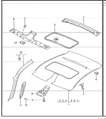

  2. That's exactly what I hear when I push the panel, glue that cracked most probably due to the very low temperatures. Thanks!
  3. I have exactly the same issue but I cannot find the TSB you refer to. It feels like the number 7 on the picture is normally glued to the roof and now got loose. The result is a very annoying squeak noise. This happended last week first when it got really cold here in Switzerland (1° F or -17° C) where I live. The cold weather that we have for two weeks is not doing the car any good. Did anyone of you take down the roof liner? Big job? Thanks Ronny
