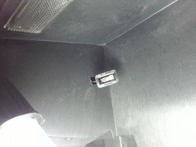

  1. I fixed the problem today, it was very much straight forward: 1) Remove the glove compartment dampers by carefully pulling them toward you, they are attached by a snap mechanism 2) Remove the 2 screws each side holding the glove compartment to the frame joint 3) the switch is top right, in my case the metal bracket just fell off 4) I removed the switch carefully with a flat screw driver, inserted the metal piece and fixed it with some epoxy that it will always stay there 5) works like a charm

  4. Does anyone know how the glove box sensor open/close works? I've worked at the glove box and a little metal bracket came off - I just don't know from where. Since then the car honks when I lock the doors. Thanks Ronny
