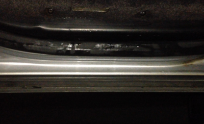

  2. Hi Loren. Im trying to locate the drains on the doors to unplug and also to unclog the weather strips so i can get rid of all the water in the carpets. Any idea?
  3. the rubber strip that goes around the bottom of the door

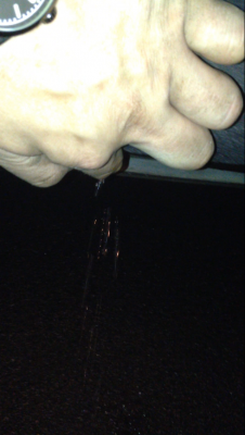

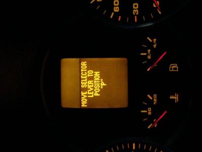

  6. Hello everyone. I need advise on few couple of items... 1. I have problems with the transmission and the key..i.e. it wont unlock the key when turned off. After driving for a while I get D with no number (telling me what gear its in) with and when turning off a message follows please put lever to PARK. Then I need you opinion on what the hell is going on with the water INSIDE my car all the doors are soaking wet in the lowest 2" but dry above that. The floors are randomly wet... action already taken : : : I cleaned the drains in the front wheels and nothing blocking it there..SO what do you guys think I should be doing next ?? I tried to take a picture of it but is like raining when i slide my finger across the lowest section of the doors. THANKS

  9. Hello. So I have posted here on renntech before about Cayenne S operating temps with no final fix for that issue. I recently had the joy of having a msg when I shut off the car saying "move selector lever to position 'P' " The indicator lights on the gear shift where it is iluminated the selected mode " P,R,N,D. The light moved as i cycle trough but alwas there is a light in D even though the lever is in P and there also light in P. Have anyone experienced this before and knows how to fix this ?? I also pulled up a few codes with durametric today and it would be great if anyone could shed some lights on those for me since im not very mechanic. Thanks
