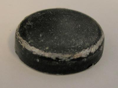

  1. That's what I was thinking; if any of the plugs in the engine came out, there should be "consequences", but you haven't mentioned any. I wonder if it was an "extra" left in there when the unit was assembled? It does look like it may have never been used, the only place that I think it could have come from is perhaps the in the return oil galley from the head to the oil sump. I have attached more photos tell me what you think.
  2. I pulled my oil pan today and found no metal filings but I found a small freeze plug about the size of a nickle. Any clue where it may belong and is it important? I have attached a photo any help would be appreciated.
