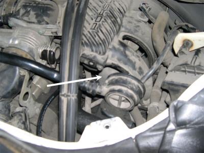

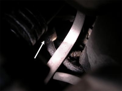

  22. After some investigating I see tht this is part of the air injection system - I belive it's a vacuum reservoir.
  23. The part I'm looking at is more towards the front of the engine - and underneath the intake manifold. It's shaped like an oil filter with a slot cut into it.
  24. Could someone tell me what the cylindrical thing is in the pic below? This is a 99 Boxster 2.5 base engine. It's hard to tell what you're looking at in the next picture, but it is a close-up of the base of the cylinder. It has a small amount of oil leaking from around the tube that's connected there. The arrow then points to a...? Thanks everyone! I'm learning...
