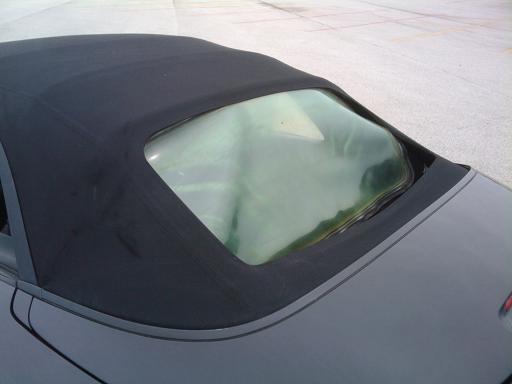

  3. Thanks, I think this is what I will do, I am going to try using the cleaning sovlent to clean the current window, if no luck them I will buy a new roll of the plastic and make my own window :)

  6. Hey thanks for the reply, but unfortunately both those are out of my budget for the top, I just spent $450 on a new starter w/install and $300 on a hardtop so I am not worried about my softop looking perfect, just better than a droppy discolored clear window. Has anyone else had this problem?
  7. Trying to fix up the rear window, on a very small budget, so replacing top is out of question. I was thinking about stitching the window back into place with black or dark blue thread, and cleaning it with some kind of plastic window cleaner (like Novus Polish, recommend by Miata owners http://novuspolish.com/) but would like to buy something that is available at Autozone or Pepboys Has anybody ever done this? I attached a picture of my top
