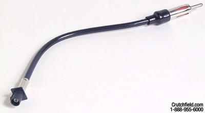

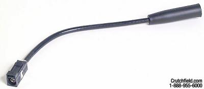

  20. Hi Jeff, in between I also found the answer in the link you sent in another thread (CDR24 Radio Removal) :thumbup: . The adapters are available at: www.crutchfield.com #12040EU20 and #12040EU10 Now I just need to find out where I can get them in Europe :clapping: Wolfgang
  21. ... ok, I bought the Drive&Play and I wanted to install it today, but.... the antenna does not fit. The CDR24 uses a small, clickable antenna connector whereas the Drive&Play has an old fashioned antenna connector. Does anybody know the 'name' of the new CDR24 antenna connector so that I can order an adaptor? Fakra? FME?.... Wolfgang
