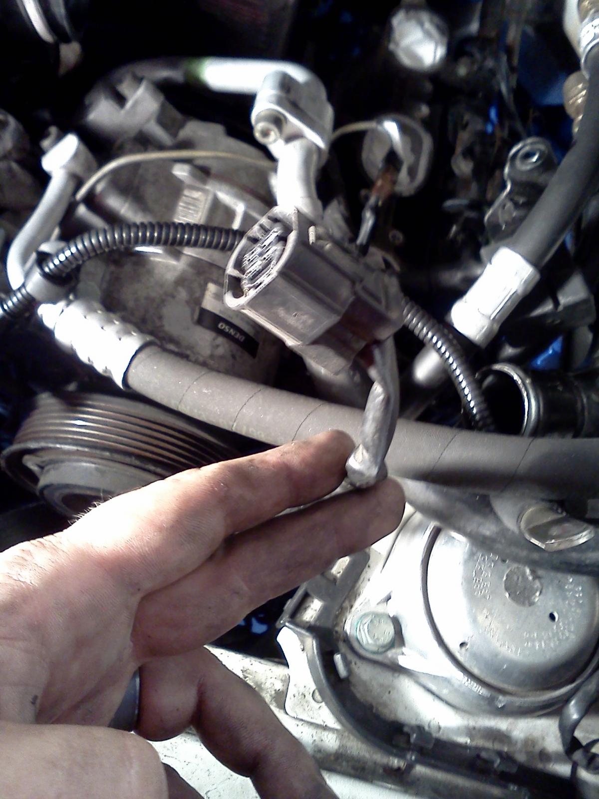

  11. Found the hose. It was bent back behind the motor. Thanks
  12. Putting my engine back in and cannot remember what hoses go here. I need the hoses for the expansion tank. 99 996 C2. Which hose I am I missing?
  13. This is on the front right near the air condition compressor. Not sure where it hooks up.
