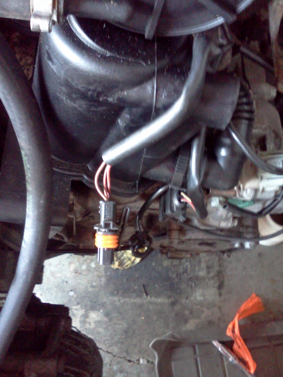

  15. Where does this connection go? I thought it went beside the AOS but it doesn't fit. The wire colors are somewhat faded but it appears to be this combination. brown w/ pink or white stripe? / red with tan stripe / and solid red. thanks
  16. This is beside the AOS on the 996 C2. I can't figure out which plug connects to it or what it is. Thanks for any help.

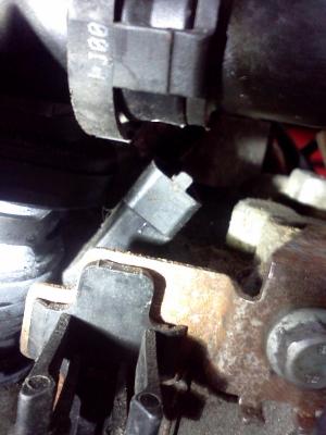

  20. Mine is part # 993.605.123.00. I need to know where the change over valve mounts and where the two lines hook up. Thanks
  21. Can someone tell me where this attaches and where the two vacuum lines go? I have a 99 996 C2. Thanks
