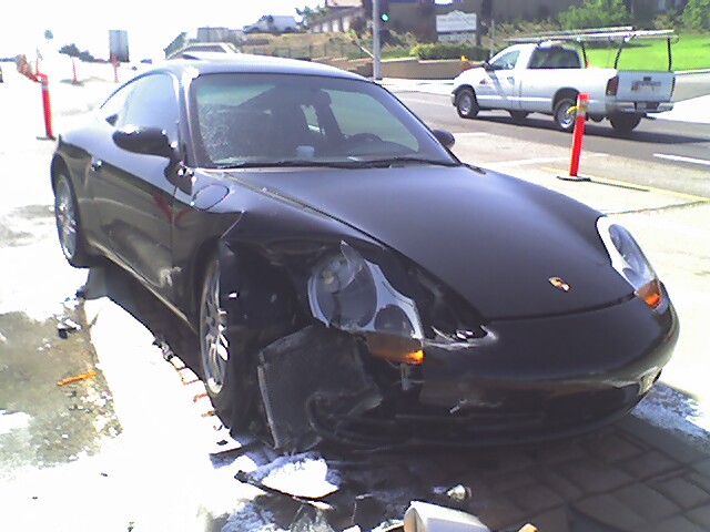

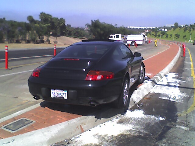

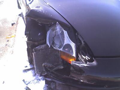

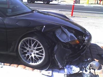

  3. Well, just got back from a nice three week Europe and Middle East trip. Hadn't drove my Porsche for a while and seeing how it was a nice day, I thought I'd take it out for a spin. After getting my coffee and donut, I was driving along one of the major streets just entering an intersection when an 85 yr. old fellow, that should have quite driving years ago, pulled out in front of me at an intersection (my green, his red) and this was the result. He told the cops he didn't even know there was a light there. I'm soooo glad I just spent $12,000 on a new motor, $1,500 on a new clutch and $1,200 on new tires. And oh yeah, I'd just washed it too. I guess I could have been on my Harley....... Obviously, I'm really bummed, but no one was hurt. It's only stuff, right? Towed it to the shop where they said there is so much frame/unitbody damage that it will be a total. Now comes the fun part. The car, a '99 Carrerra with around 68,000 miles was near perfect. And a brand new engine with warranty to boot. Knowing that the other driver's insurance company has to put me in an "equal" car, I need to get more than just Blue Book, in consideration for the new motor and warranty Does anybody have any ideas how to maximize my position in this?
