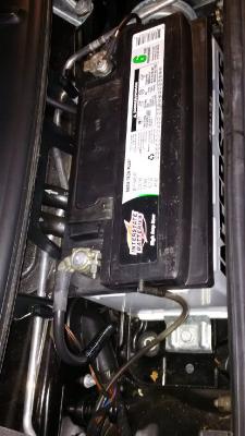

  12. 2011 Boxster S Thought I would pass around that Interstate MTP-94R/H7 is an exact replacement for Porsche Battery 999.611.080.20. See photo below. I purchase the battery at local parts store. List price is $210.95. Initially quoted $169 but purchased at $148.90 after asking parts person if that is the best price he could give me. It has a 3 year free replacement warranty anywhere in the US. I plugged in a battery maintainer while changing and I kept all settings. When first started I had a PCM failure but everything reset after a few feet of driving.
