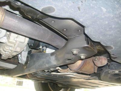

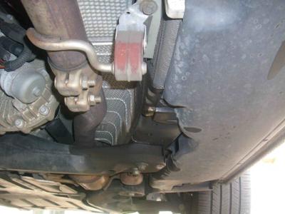

  3. Could someone please help me understand where the source of this oil leak could be (Cayenne S) ? Oil has soaked the car's underneath. I thought these pictures can better show the area than I explained it. I do not see any drop of oil hanging there or even on the ground. The soaked area is also very much solid like the oils are mixed with dirts and solidified and stuck to the chassis... When I pressed my finger and dragged on it, it is like 1 to 2mm of oil and dirt thickness that gets clean from the chassis... I do not think this is being Transmission fluid because that is not red at all or watery... I never had engine oil level drop in the winter, but 2 months ago I noticed about 1 liter of oil level has dropped and I top it off. Just thought that might be what people talk about natural engine oil consumption on Cayenne S and Turbos but might be something else ! Thanks for you help.
