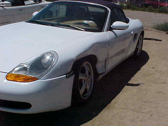

  5. Logray, Thank you for your information. I will keep you informed. BTW when something goes wrong it just not seem to stop. The mechanic dropped by on Sunday evening at 6:00 PM with photos of a dent in the drivers side air intake. No note was left by the punk. Thanks for the advice, Bob
