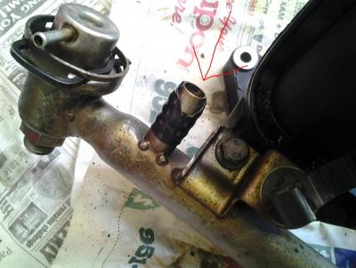

  1. Thank you for the reply. I think that non removable specialty hose is about $150-$200. Would a fuel line hose from any auto part store work? Has anyone tried it?
  2. Just curious, has anyone replaced that circled fuel line with an auto store bought fuel line hose ( not a Porsche replacement part) ? If so, what is the size of fuel hose diameter? Is there a particular type of fuel hose that I could use as a replacement? Any help is greatly appreciated.

  9. thank you folks for the reply ( 1998 Boxster 2.5 5 speed ) No wonder it was really hard to pull that hose off the metal fitting. Should I just remove the black inner part of the hose from the metal fitting ( pic. 1 ) and cut about an inch of the hose ( pic. 2) and re-attach it?
  10. Hi Folks, I am in a process of re-assembling the intake manifold and was wondering what I would need to use to "glue"/re-attach the fuel hose to the fuel rail. Please see the attached pictures. When I disconnected the fuel hose, I realized that it may have been "glued" and I accidentily ripped it from the hose. Any help is greatly appreciated.
  11. Folks, Thank you very much!
