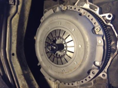

  9. I was changing the clutch in my garage (barrels of fun!!!) and I noticed this broken plastic rod. I am not sure what it is. Do you have any idea? It is located inside of the suspension area of the rear drivers side wheel. The picture is taken from underneath the car laying with my feet facing the exhaust and my head facing the front trunk. I also attached a clutch picture just because I am proud of myself!
