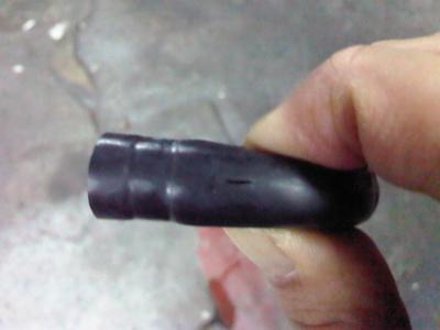

  18. Thanks jpflip, I rang and ordered the new pump 5 minutes before I found this leak, and then I rang back to cancel the order :clapping:
