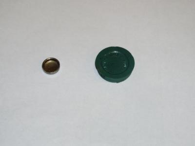

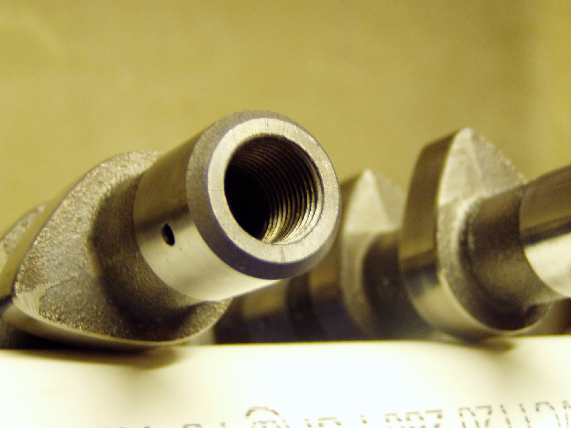

Here is a close-up of a cam with the expansion plug blown out. Notice the shoulder inside the cam where the diameter of the hole gets smaller. It is only about .2-.2.5” inside the chamfer on the end of the cam. Here is a picture of the expansion plug that came out, and the cam cover plug. Notice how shallow the expansion pug is, only about 1.8” deep. This cap is pressed into the end of the cam, and the widest part is the top/hollow end, so it needs to go all the way into the end of the cam so that the widest part is beyond the chamfer. You don’t want to reuse an expansion cap as they are pressure/interference fit, and once they lose their shape/diameter reuse is very dangerous. All the domestically available expansion caps I found (from Dorman and other) were 2.5+” deep, so that the widest part would not be far enough in the properly fit, this is because of the shoulder inside the cam. And Porsche will not sell just an expansion cap. Here is a close-up of the cam with the end drilled and threaded. Notice the hole in the bearing area. This feeds oil to the bearing/journal at the end of the cam, so it is critical that the hex plug not interfere with this hole/oil flow. So the depth of the hex plug is critical. Here is a picture of the hex plugs. The machine shop used standard, easily available plugs and shortened them so that they would not interfere with the oil passage. Here is a close-up of the cam with the hex plug installed. Notice the Red Threadblocker used to secure the hex plug in the end of the cam. I am going to modify my home made tool so that it will fit into the hex of the plug to hold the cams. I am not really worried about it pressing against the hex plugs, with the thread and threadblocker it is not coming out. Here are a couple of pictures of the other ends on the intake cams with threads and plugs I thought i would be putting the engine back together and back in the car this weekend, but some parts were delayed until next week, sent by ground by mistake, they were supposed to be overnighted for delivery yesterday or today, kind of frustrating.

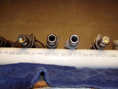

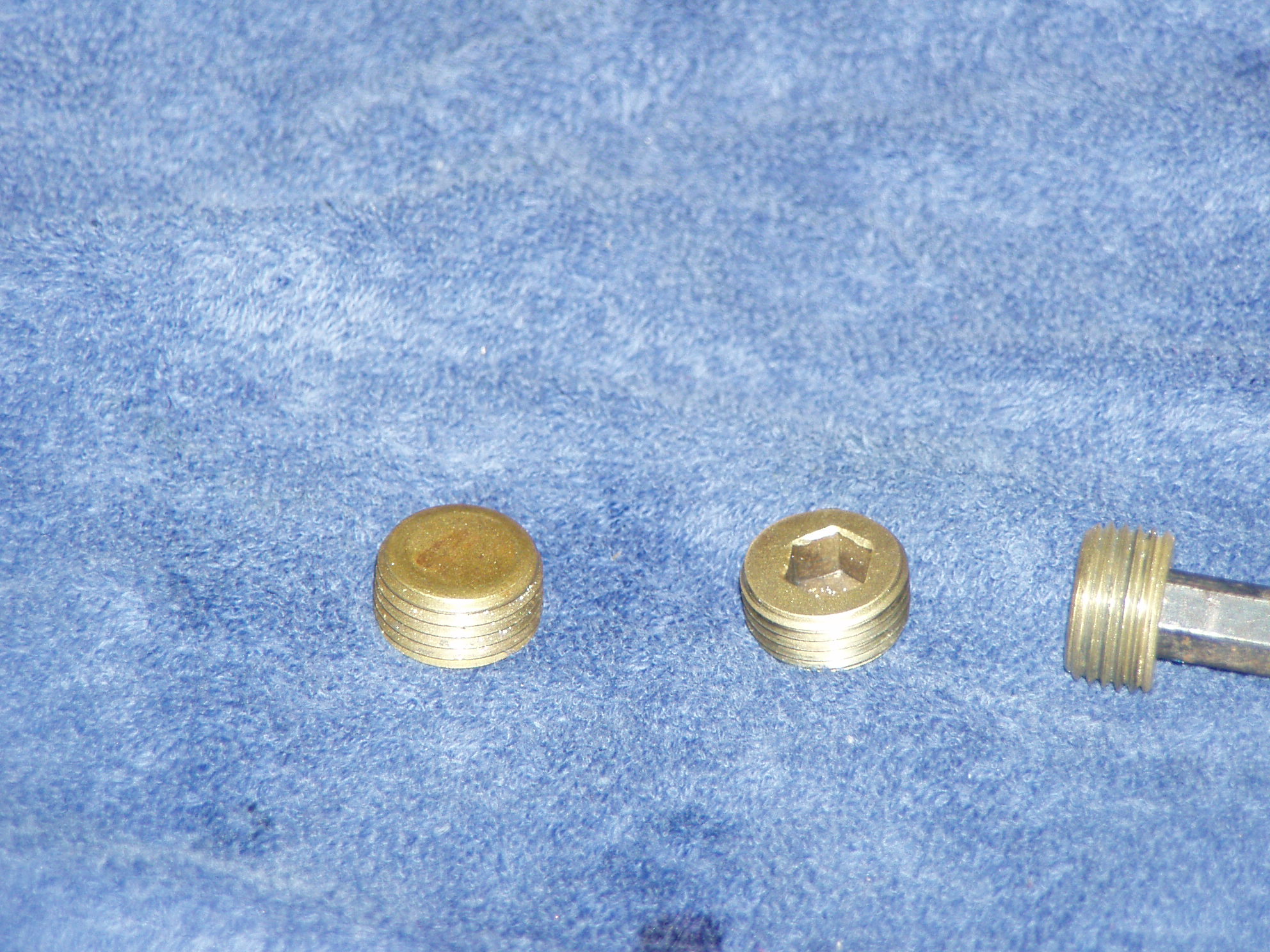

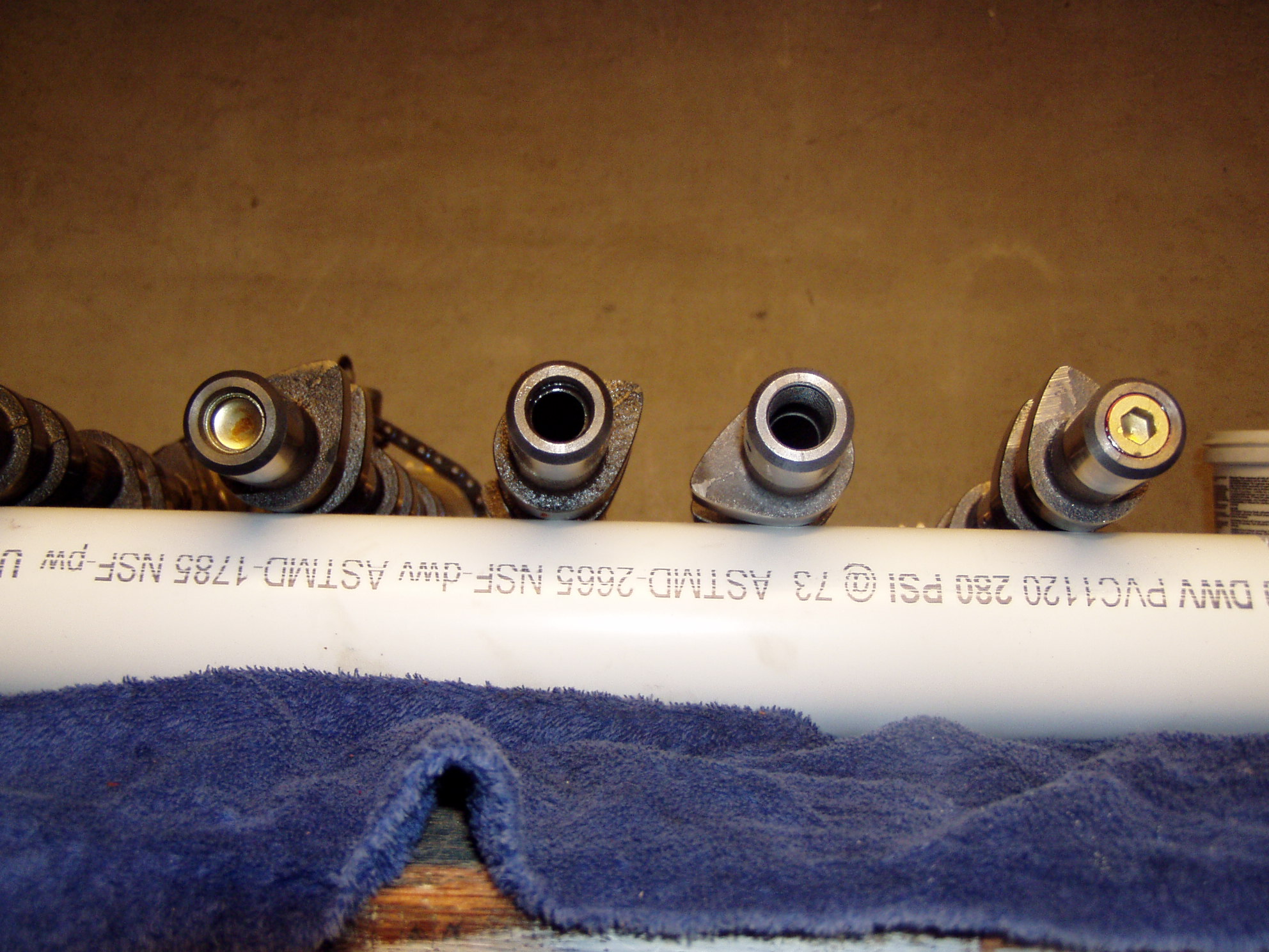

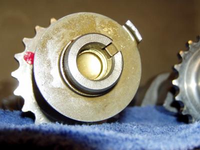

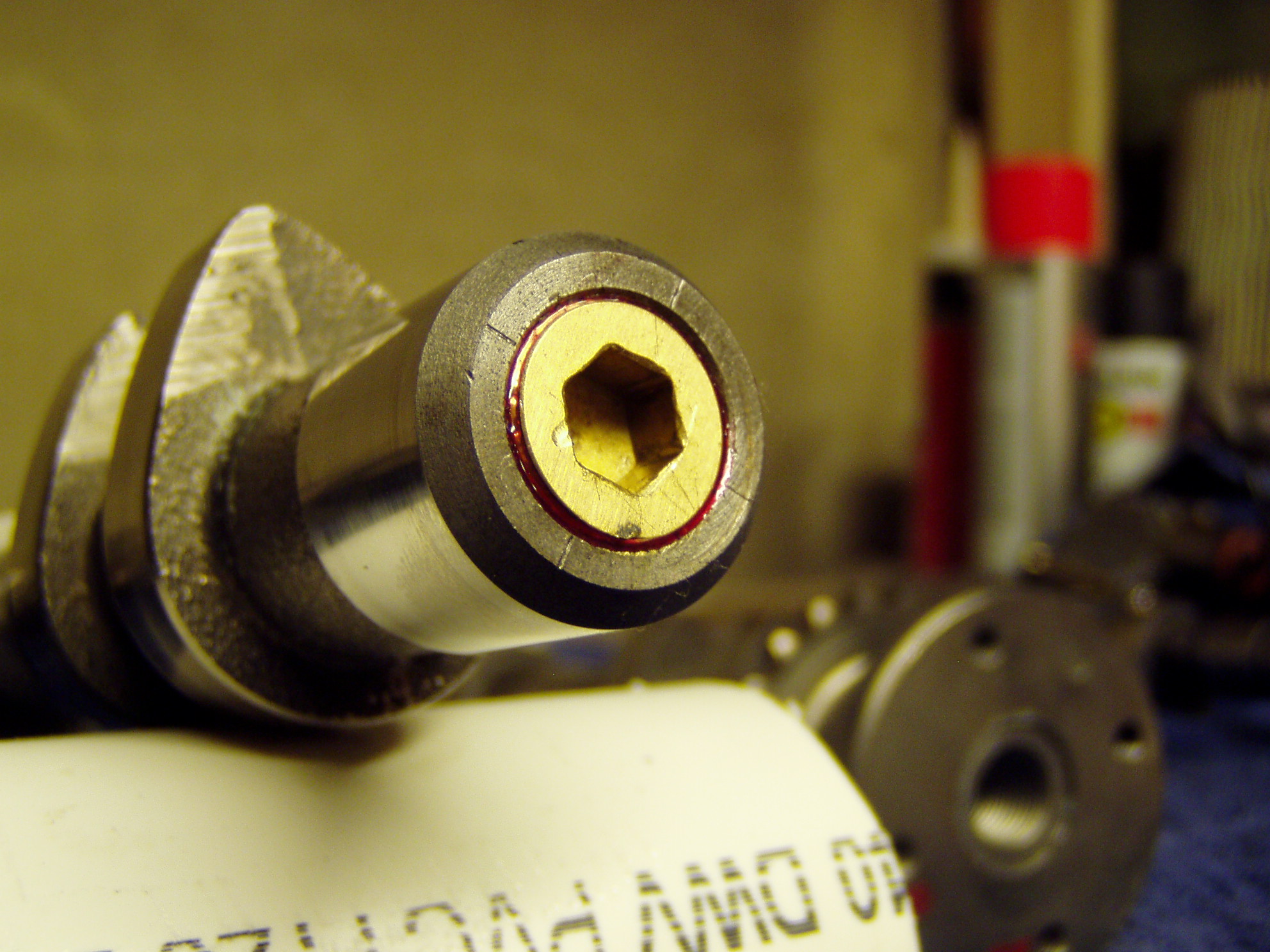

Another update on the saga on my intermix problem and the repair of the engine. Those of you who have been following it will remember that I had an expansion plug blow out of the end of a camshaft and have been struggling with that problem. Finally sent the cams out to have the ends drilled, threaded and plugged. Here are pictures of the camshafts. The first shows four intake cams, on the left is a cam with the expansion plug in place, the next shows a cam with the expansion plug blown out, the next is a cam that has been drilled and threaded, and finally a cam with the Hex plug installed. Here is a close-up of the cam with the expansion plug in place. In this case the plug has not been “deformed” by my home made tool. Here is a picture of my home hade tool. The tool fits in the end of the cam to hold down the cam when the cam cover is removed. The manuals give specific instructions on the depth/setting of the bolts that fit into the end of the cams. I did not think this was critical, not even being aware of the expansion plugs, so I screwed my bolts pretty far in, pressing against the expansion plugs. I believe this was a major mistake. Here is a picture of the tool inserted in the end of the cam with the plug in place. The hex driver bolt I used is actually small enough to fit inside the expansion plug. I think it should be a larger size head, so it fits into the end of the cam, but not into the expansion cap, However there is not much room beyond the expansion cap. I have not seen the factory tool to see the size of the bolt heads on it.

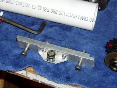

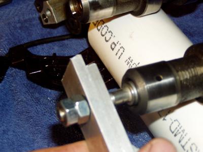

Checked with Sunset, the tool 9612 (cam allocator is $478 and is in Germany so a month away. Baum Tools seels almost an exact repica for about the same price. ZDmax has a substitute for $216. It turns out that the two cams are set relative to each other by the chain, the tool is used to move the cams relative to the IMS/Crankshaft. The problem witht the plugs is that they can only be about .18 inches deep. There is a shoulder in the hole on the end of the camshaft and the widest part of the plug has to fit weel into the end. All the plugs I found werre .25+ inches deep, so that the widest part of the plug would not go in far enough before hitting the should in the end of the cam.
I have a question about the use/purpose of the Porsche Cam alignment tool 9612 ( and the equivalent tools available from Baum Tools, ZDmax and Pelican). The descriptions say that the tools is used to secure the intake and exhaust cams in relation to each other when setting the cam timing. However, the relative position of the cams to each other seems to be controlled by the number of chains links on the sprockets and the cam tensioner/solenoid. You cannot change the relative position of the cams to each other once the chain is set on the sprocket. It seems that the real purpose of this tool is to set the position of the cams to the sprocket on the intermediate shaft chain, and thus the position of the cams relative to the crankshaft. Is this really the case? This comes up for me on my project repairing the intermix problem on my car. For those of you who have been following my on-going project, after having the cracked head fix and reinstalling it, the car started up but blew an expansion plug out of the end of the 1-6 intake cam. The cams are actually hollow and carry pressurized oil to the journals on the cams. Each end of the cams has an expansion plug, and on occasion these can blow out, which can lead to a complete loss of oil quite quickly. In any case I caught mine if a few seconds and shut the engine down. It is not advisable to reuse the old expansion plug as it has already been deformed and could blow out again. Porsche does not sell a replacement plug ( they will only provide a new cam for $800+ as opposed to the plug which costs less than a dollar) and the plugs available in the US are the right diameter, but are two deep to go into the cam far enough to hold. I searched and searched but could not find a properly sized plug. So I found a used set of cams. When I removed the cams I marked the position of the sprocket from the IMS chain on the exhaust cam flange so that I could put everything back in the exact same position. However when removing the intake cam from the cam assembly, the chain came off both cams, so I had to reinstall the chain based on the colored links and marks on the cam. I did not think this would effect the marks on the exhaust cam flange and the IMS chain sprocket, but now when the engine is set at TDC and the marks are aligned, the cam groove is not straight up and down. So I want to make sure that the cams are set correctly relative to the crankshaft. I have devised another way to rotate the cams to set the position, but I am perplexed that the sprocket and flange don’t seem to line up the way they did before. Any thoughts on this?
