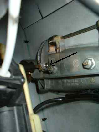

  6. :beer: Solved problem of driver's door not opening from outside. There is a pin that connects the door handle lever with the lock action arm. The pin broke of just fell off. The solution was to attach them with a small screw and nut. (Thanks "adsach" to for the panel removal info) Attached is a picture of the handle from the inside. Hope this info can be used by others running into same problem. Rolando

  11. A diagram of the door/lock mechanism could help as well as instructions to remove the door pannel. Door also locks and unlocks with remote or key -meaning that two pools from the inside handle are needed when locked, one when unlocked. <_<

  14. Yesterday I replaced the ignition switch (Boxster '98 90K miles). Key moves freely now and problem with starter keeping-on after engine starts seems to be solved. (Thanks deliriousga for your help :cheers: ) New problem: as soon as I reconnected the battery cable, the door on the driver's side does not open from the outside :unsure: Passenger door ok, driver side ok from inside, behabes like locked but can't be unlocked with the key or remote. I imagine that this is completely unrelated problem to the ignition switch - what could be wrong?
