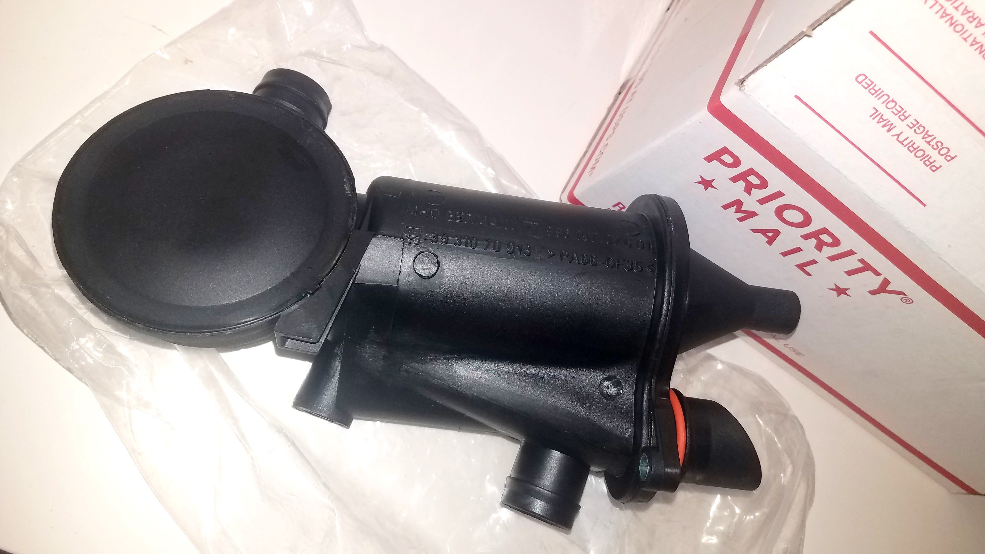

  10. Boxster Power Steering Pump Replacement Hi, I just replaced my power steering pump and I looked everywhere for a DIY guide, the only thing I found was the tensioner pulley removal which involves removal of the power steering unit in the shop manual, which was way too vague and incomplete, I will try to do do a better job in explaining but I'm taking who ever attempts this job is mechanically inclined with that said I will skip over the obvious parts such opening the engine access panel and removing the accessory belt (make sure you lo Author kamran66 Category Boxster (986) - Common Fixes and Repairs Submitted 02/12/2012 08:58 PM
