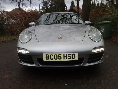

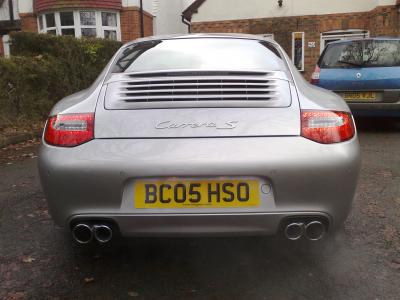

  1. Yes those are the heat sheilds but the bottom of the bumper wraps around the bottom of them and the screw holes are in a different place. I believe the plastic solid parts on the heatshields are a different shape hence the new bumper stretching over them rather than sitting flush. Some bits have to be cut off or modified, its not ideal anyway.
  2. If you have a centre rad then the middle vent is just a clup in trim that leaves the front open for ventilation, it is different to mine which is solid with deflectors left and right.

  7. I actually used some hosing off another car, think it was a Mercedes, its all the same diameter, chopped it up and extended the existing piping. If you speak to your Porsche dealer they can sell it you in a length it is standard washer hose be the same for all the porsche models i guess. The hose fixes in the bottom part of the bumper at the bottom, fit you grills first and then locate it in, its a bit of a tight fitting thats why its best to get the lenght correct before fitting properly. To put the metal strip back on the rear bumper is a couple of small rivets, you can do it with a hand rivet gun, easy to do. If you haven't got one you can buy cheap from hardware DIY store, in fact in the UK you can buy them fromt the cheap pound shops. The heatshieds have fixings in them that the bumper attaches to. As the Gen 2 bumper has locating holes in a different place the existing heatshields dont fit very well and protude slightly. Cant remember off the top of my head the price of them but they weren't that expensive may be 100 pounds per side. Personally i would change them as you dont want the bumper bulging out at the sides or a view of the heatshield with bits cut out. It will still be visible even when the car is on the ground, if you look at yours now you can see them behind the back wheels.
  8. The front of the car, looks a lot better. Thing is then need Gen 2 wheels and wing mirrors, where do you stop though lol
  9. One thing i missed off, exhaust pipe trims for the bumper, these aren't cheap £60 each!!
  10. 1) You have to replace the whole washer jet it is in a complete unit it is not just a pipe connected to the top bit that sticks out. The jets are about 4 inches long and lock in to the bumper complete in one unit with a chrome top. The hose is standard washer jet hose about an inch in diameter. The existing can be used vou need about another 2 feet of hose and a t piece adaptor to make it all fit properly. The hosing was the only part that needed to be fitted properly because the air scoops behind the bumper have a recess for the pipe. The rear bumper at the bottom centre between the exhaust pipe holes has a slide on metal strip where a screw locates it to the bottom of the car. This is pot riveted on to the bumper. You will need to take this off and fix to your Gen 2 bumper. You could trim the heat shields but the Gen 2 bumper locating screws are in a different place than the Gen 1 so it will need modifying a bit. Also as the back of the car is pretty open to the eye, no inner wheel arch trims it may look a bit ugly and defeat the whole idea of upgrading to the newer spec.

  13. I did front and rear conversion to my 997 C2S, in short bits you will need, no part numbers i'm afraid: FRONT BUMPER BUMPER GRILLS , LEFT AND RIGHT AND CENTRE SCOOP (CHOICE OF 2 BETWEEN AUTO CAR WITH CENTRE RAD AND MANUAL) NEW WASHER JETS X 2 (OLD ONES DIFFERENT SIZE AND CANT BE MODIFIED) NEW WASHER HOSE - OLD HOSE ISN'T LONG ENOUGH AND NEEDS MODIFYING TO COMPENSATE ANGLES OF NEW JETS. BUY NEW LENGTH FROM PORSCHE BEST, THIS IS THICK HOSE INSIDE RADIATOR SCOOPS. THESE SIT BEHIND THE BUMBER AND ACROSS THE RADS. OLD ONES ARE WRONG SIZE FOR NEW BUMPER LED DAYLIGHT RUNNING LIGHTS 2 X MINI LOOMS THAT CONNECT TO LED LIGHTS AND WILL BE SPLICED IN TO EXISTING LOOM. FRONT LIGHT CONTROL MODULE REAR REAR BUMPER REAR LIGHTS - OLD LOOM HEADS WIL FIT IN ALTHOUGH SLIGHTLY DIFFERENT SHAPE, SLOWLY PUSH THEM ON, BUT MAKE SURE THEY FIRMLY CLIP IN, REAR CONTROL MODULE REAR BUMPER FIXING STRIP. THIS IS WHAT THE BUMPER SCREWS LOCATE TO FROM INSIDE TOP OF ENGINE BAY. GEN 2 SPACED OUT DIFFERENT. YOU COULD MODIFY YOUR OLD ONE BY DRILLING IN NEW FIXING HOLES LEFT AND RIGHT EXHAUST HEAT SHIELDS. DEFFO CHANGE THESE, SOME PEOPLE USE THE GEN 1 HEATSHIELDS BUT THE BUMPER WONT SIT PROPERLY SO IF YOU ARE GOING TO THE EXTENT OF FACELIFTING BEST TO CHANGE THESE USE THE BOTTOM CENTRE OF THE OLD GEN 1 BUMPER METAL STRIP TO ATTACH TO YOU NEW GEN 2 BUMPER. YOU WIL NEED THE OLD POT RIVETS DRILLING OUT AND REFIXING TO YOUR NEW BUMPER REVERSING SENSORS- DONT BUY NEW ONES*** YOUR OLD ONES WONT FIT IN THE HOLDERS THAT COME WITH THE GEN 2 BUMPER. WHAT YOU CAN DO IS HEAT YOU OLD BUMPER UP SLIGHTLY WITH A HEAT GUN AND REMOVE YOUR GEN 1 SENSOR HOLDERS. THESE CAN THEN BE GLUED TO YOU GEN 2 BUMPER WITH WINDSCREEN BOND OR STRONG 3M TAPE. ENSURE YOUR OLD ONES ARE FREE FROM OLD GLUE AND FLAT AND CLEAN BEFORE FIXING TO YOUR GEN 2 BUMPER. THIS IS A BIT OF A TIME CONSUMING EXERCISE BUT SAVES YOU THE BIG EXPENSE OF BUYING 4 NEW SENSORS. NUMBER PLATE LIGHTS CAN BE TRANSFERRED FROM YOUR OLD BUMPER. LIGHT MODULES WILL THEN NEED PROGRAMMING AND SET TO LED'S SOME LATER CONTROL MODULES CAN BE CHANGED IN THE FIRMWARE, REARS I THINK HAVE LED OPTION BUT THESE ARE ON LATER GEN 1 CARS. FRONT WILL ALWAYS NEED CHANGING, THINK IT IS THAT WAY AROUND ANYWAY. MY 2005 NEEDED NEW MODULES FRONT AND REAR.
