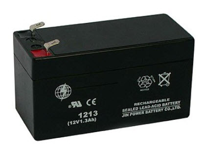

  7. Yes I am sure. But I need to remove the spare tyre and unscrew the Bose subwoofer again to take its picture. I am pasting a picture of a similar battery. It was almost the same one. I beleive it belongs to BOSE sound system and that's why I haven't replaced it.
