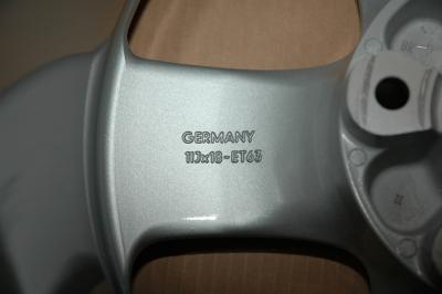

  7. No, they are only 18s for the 911. The Cayenne did have bigger ones though. Also, there is no lip to polish on these. I do have 2 brand new rear wheels still in the box for sale. 18x11. $3300 was paid for these, but I'd sell them for $1000. See attached pics.
