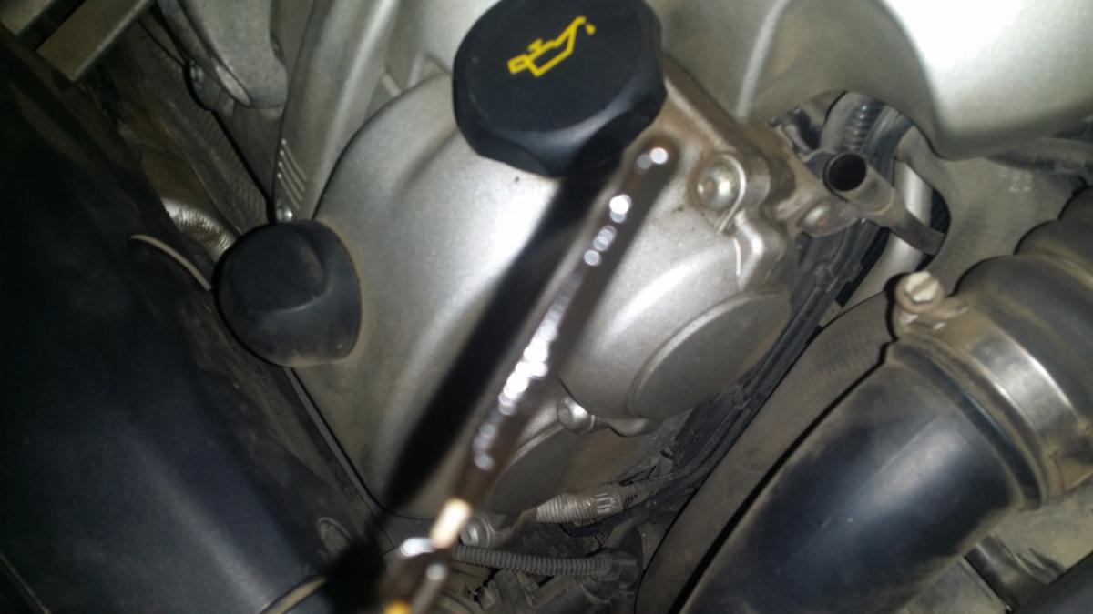

  5. hi im hoping its not the head gasket ,I had a misfire on number 3 cylinder so I changed all the coil packs and sparkplugs put it all back together it ran fine for 1 day now every time I start the car I get a big puff of white smoke on from the left side exhaust ,it stops after a couple of seconds I have checked the water which I topped up with about a small glass full ( it has been at least a couple of months since I checked it ) .I have noticed a little oil coming from the sensor on top of the same side rocker ,not sure how to take it off so I will look on the site .is there anything I might have knocked off while changing the coils that might cause this? I have just moved across the country and my mechanic is around 500 miles away .. any help gratefully recieved
