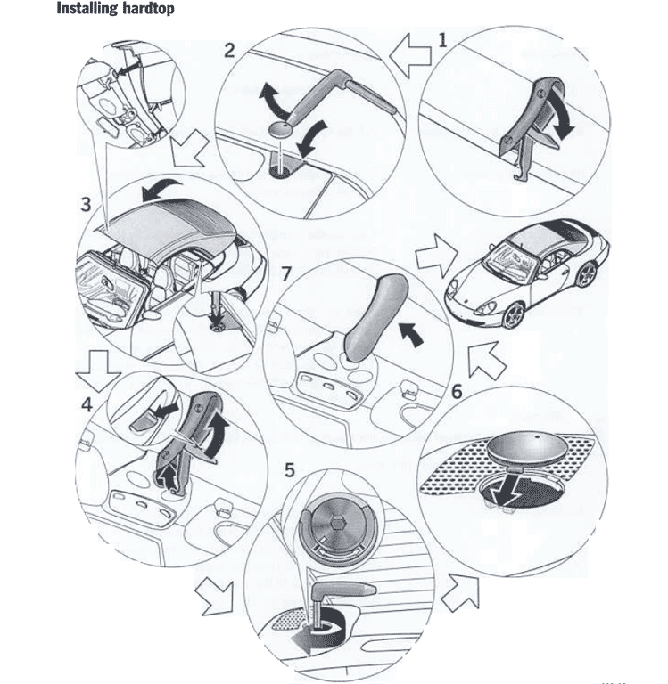

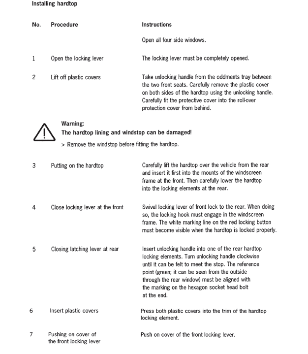

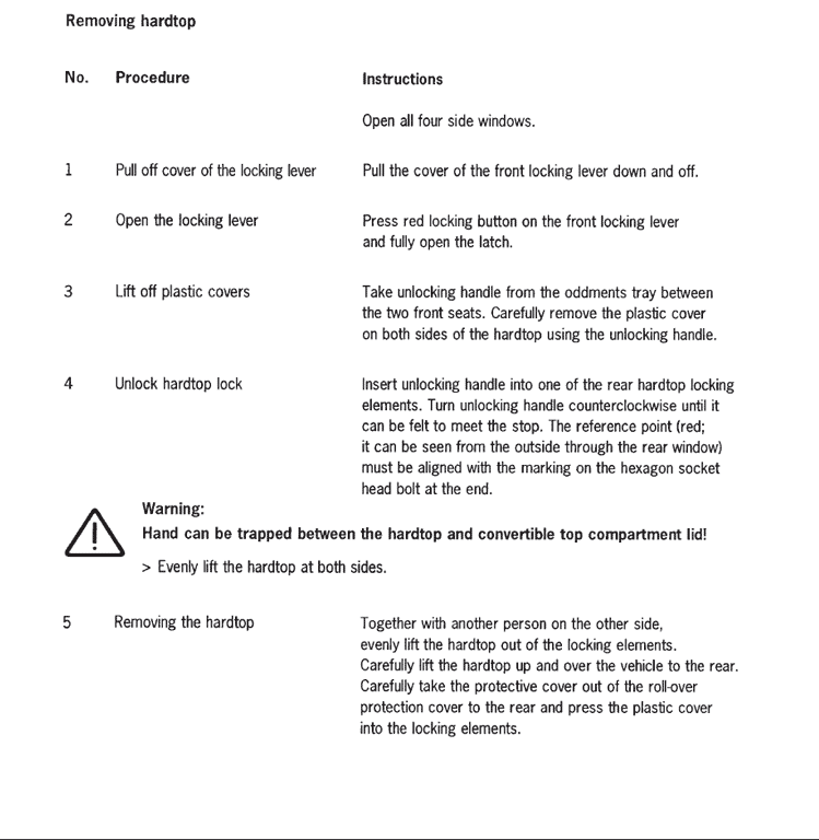

  2. This should help.....Removal and Install diagram and instructions. Good luck! One of my wife's cars is a cabrio, and I find it nice when the weather gets chilly to install the hardtop..... So it is useful between the time it gets too cold for top down..until the snow starts and the car goes in storage. Also nice for longer trips as it is quieter. DC

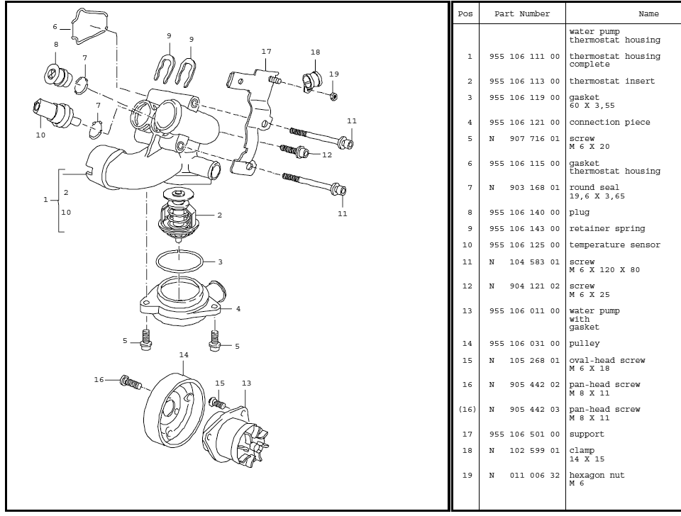

  5. In case anyone else has this issue, I did find this diagram that may be helpful. Has the diagram and the parts list as well as part numbers.
  6. Thanks for the info and advice. I have the part ordered, but since it seems like a pain to reach, and there may be other issues, I may just break down and drive the hour to the Porsche dealership. I also need them to fix the air bag fault anyway....That light is on as well. A shame to have these problems when it only has about 26,000 miles <_< I guess I will see how lucky I am feeling when the part comes in. Thanks again guys.

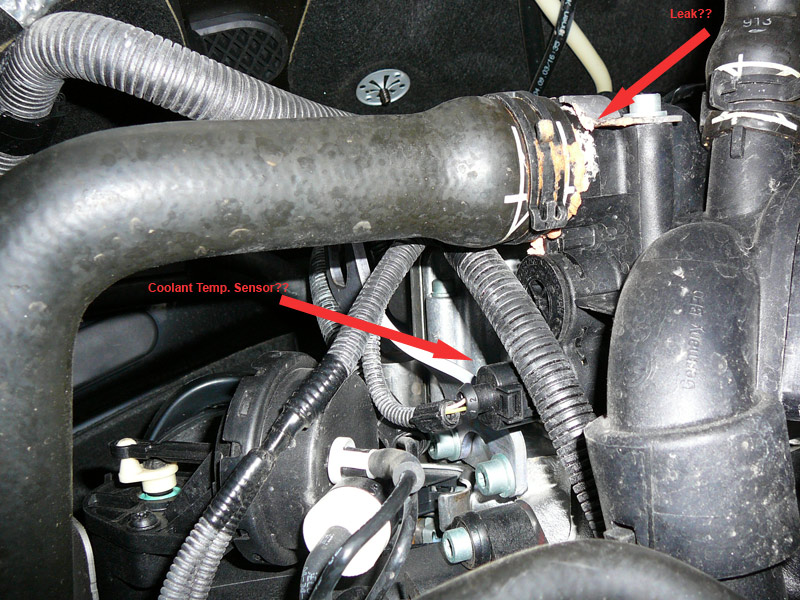

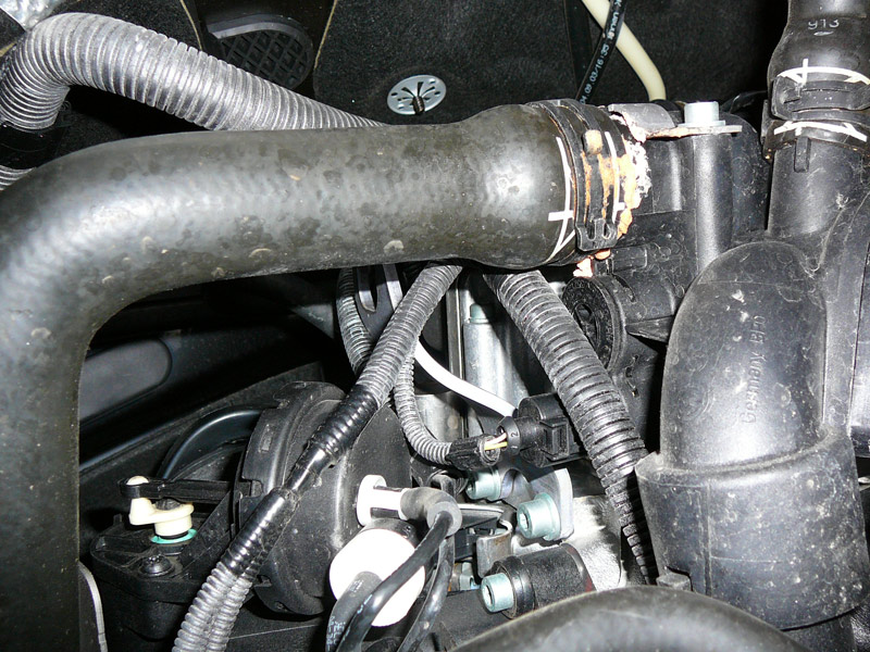

  7. Here is a photo of the area and you can see what may be a leak? Thanks Donnie
  8. Hi Loren, I did lay under the vehicle last night and looked up through the plastic covers. There is a hose about 1" that is very near the CTS and where the clamp attaches it to the water neck, it looks like a little orange corrosion (like perhaps a leak?). There is never any noticeable coolant in the garage, or from what I can see, nothing on the engine?? I can try to get a photo if that will help you. Thanks! Donnie
