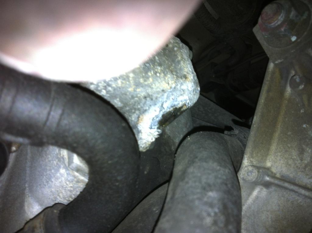

  1. Sure you've fixed by now, but outside of the squeal/squeak up to 2-2.5k RPM you had the same exact symptoms I had. Starts with a small drip. Went new Pump because its bad, hoses and clamps because its 13 years old. Also, there is a coolant plate, mine had a leak - i had the gasket replaced. $24 part and I think I was quoted/paid less than an hour labor for that part of the job.
  2. I heard a slight squeak at idle and gradually changed pitch and got louder to 2000-2500 and 300 miles later the water pump went... Squeak came from play in the pulley, once off you could hand spin it (with slight pressure on the pulley) and it sounded the same - just not as amplified as 2k RPM

  5. Not sure if you have solved this (hope so as its a couple months old :) ) but for anyone else in a 99 996 (and maybe some newer) finding coolant leaks my shop just changed a passenger side coolant plate and gasket. I was also told another common problem is the coolant expansion tank is prone to crack/leak - water pump is obviously closer to the driver side. Ill try to link to a picture of the "before" repair (not the greatest shot but leak is visibile)https://docs.google....2VnBtMS1SVWI4QQ
