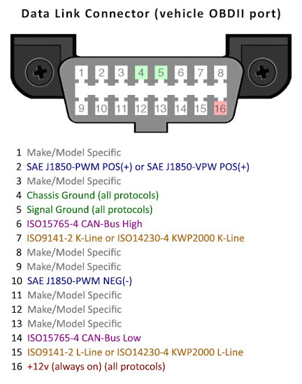

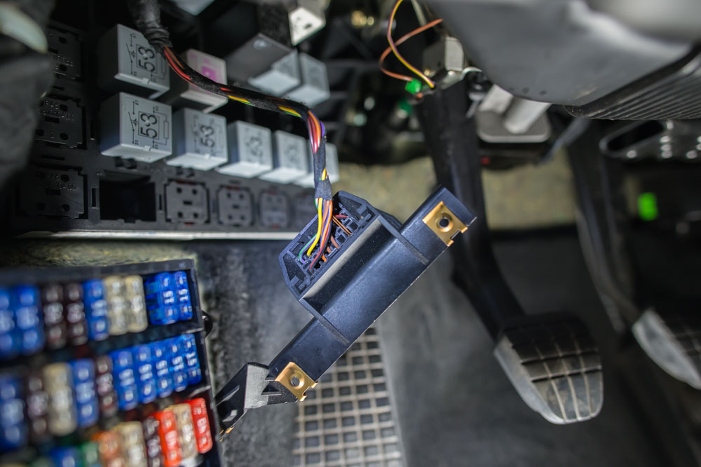

  2. After much messing around it appears that some of the pins in the OBD2 port are not getting proper contact. I pulled the fuse box cover and surround then reattached the durametric and it was able to read the DME. When the panel and port are reassembled the power light on the durametric connector is intermittent and clearly so are the connections to some of the other pins. I think its likely that the problem is on the 911 side of things. Rather then mess with all the pins in the connector what pins are required for communication with the DME ? Is this a common problem ?

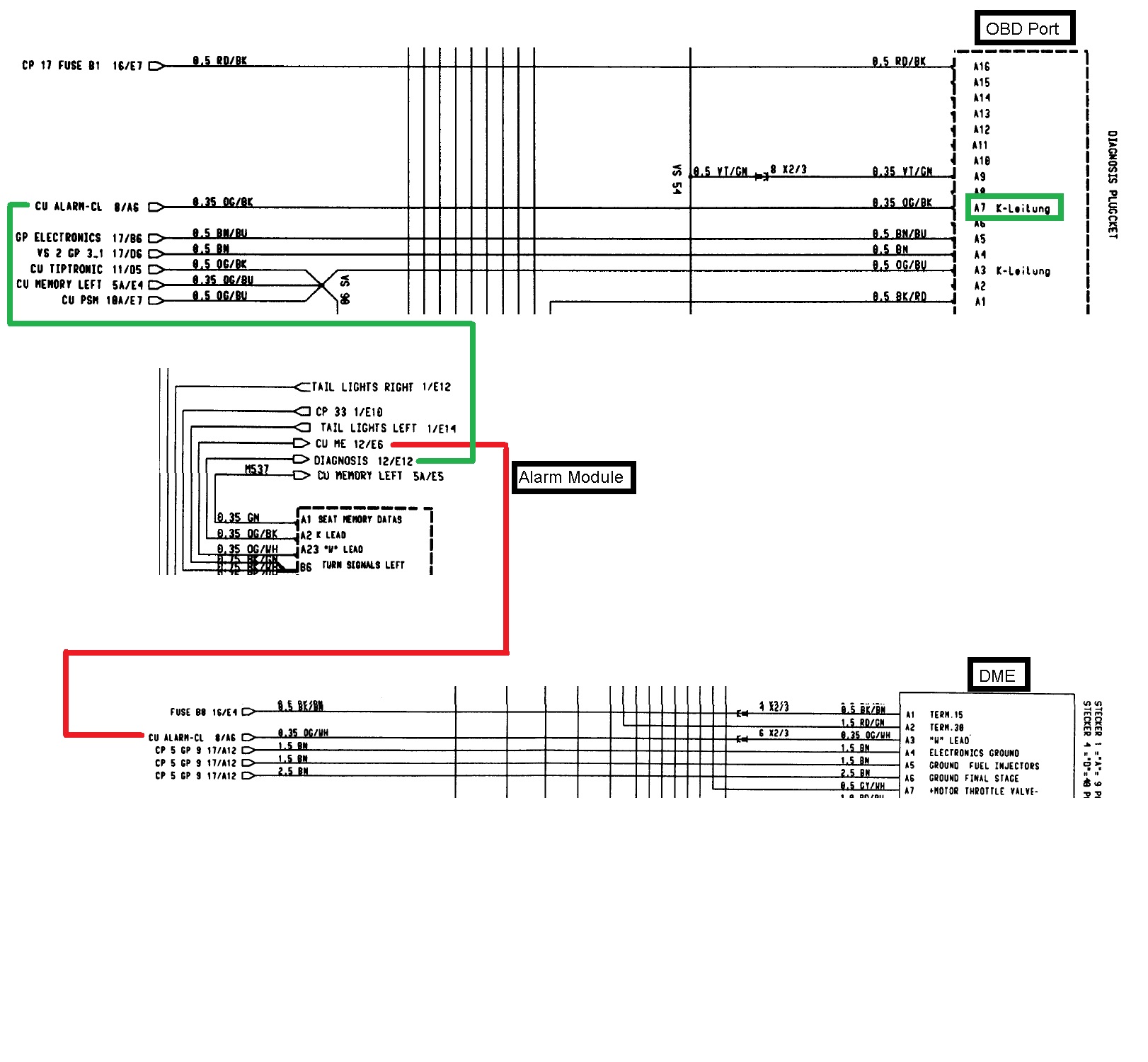

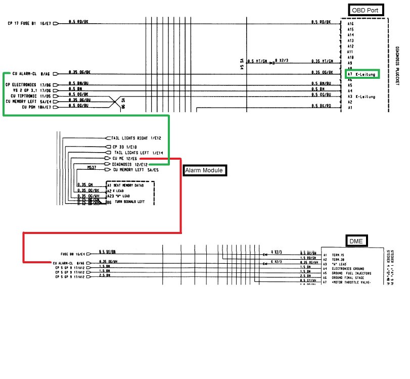

  3. I have looked thru the 2001 wiring for the 996tt diagram that is floating around. I'd like to confirm what I am looking for so I can trace the run from the OBD port to the alarm to the DME. The k-line pin is #7 on the OBD plug and corresponds to an OG/BK orange/black wire. This wire connects to the "CU ALARM-CL" (AKA M525 module, alarm or immobilizer) on pin A2 (drawing labeled "K Lead" ) and enters as an orange/black wire. The line exits the alarm module via pin A23 as an Orange/White (drawing labeled "W Lead"). It enters the DME on pin A3 as a Orange/White lead (drawing labeled "W-Lead"). Given that this is a single lead I assume that the return is via a ground common to all the units. Also the term CU is everywhere on the wiring drawings, what is it an acronym for ? Also the 2nd attached file highlights a symbol and some numbers from the wiring diagram, any idea what they represent. Perhaps its a connector ? Richard: The Pin 21 reference points to a specific location, drawing reference ? Thank you for your help gentlemen

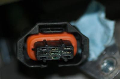

  9. Well its worse than a plug change. The sensor is just behind and above the last cylinder on the drivers side (#3?). I removed the pre-cat oxygen sensor and the #3 coil pack t get better access to the fastener. The fastener (5mm allen) is installed with blue loctite making it really hard to break loose. Could barely get the 5mm 3/8 drive socket in it and there wasnt a lot of engagement to be had since the chassis interferes. Finished the job with a vise grip on the side of the fastener (1/2 turn at a time). When I got the connector off I was greated with this. Sensor look about the same. Think there was a small coolant leak that I recently got fixed. Used contact cleaner and blew the plug out with compressed air. Will try and scrape the pins. There is no extra length in the harness to pull the plug out for easier access.

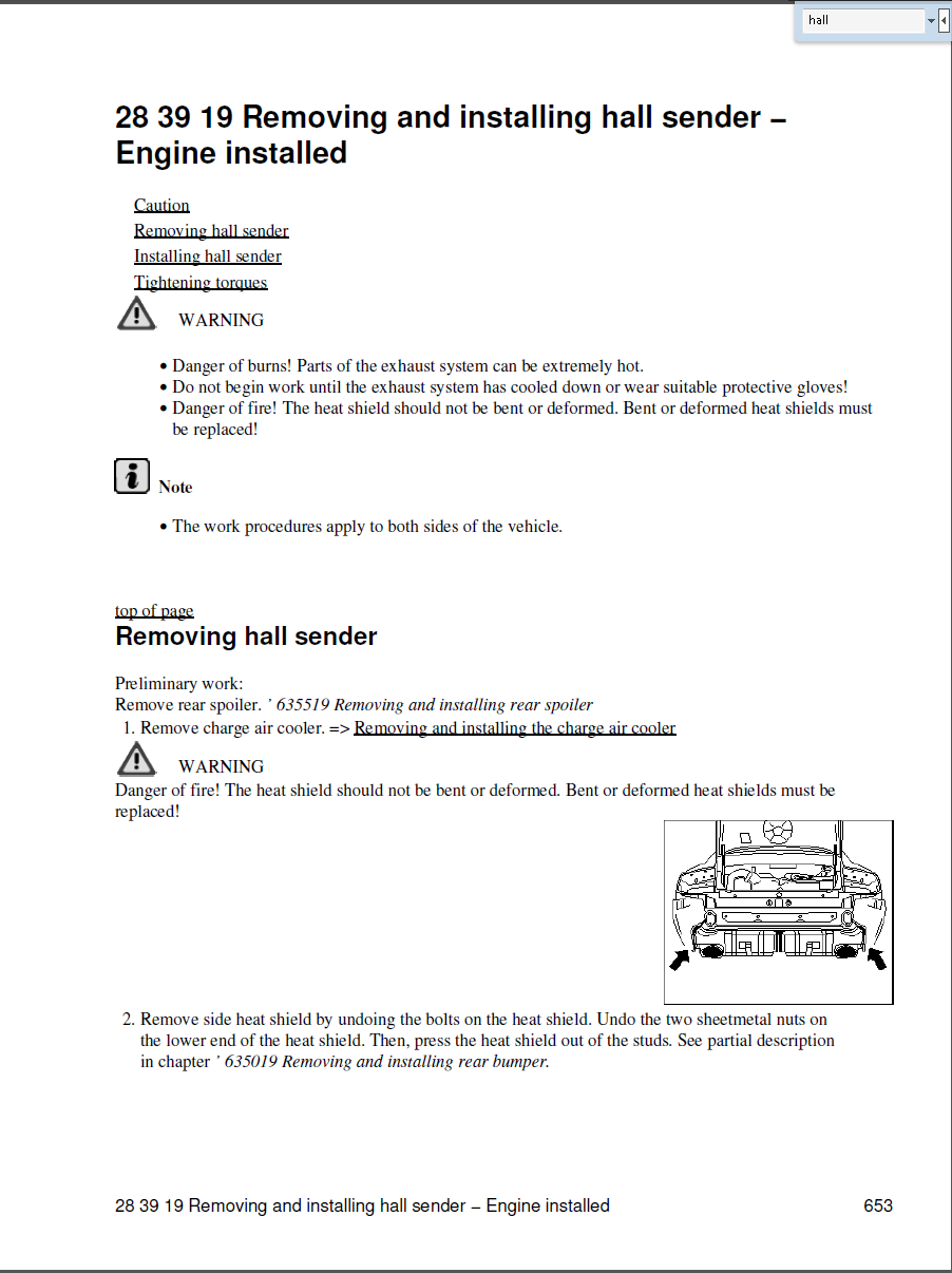

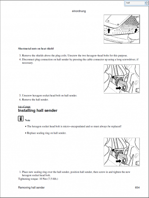

  10. Well it appears the germans call the "Cam Position Sensor" a "Hall Sender". Its covered in the Technical Manual for the 911 996 Turbo (pages 653-655) . I have attached the pages for reference. Based on the description its no worse than a plug change.
