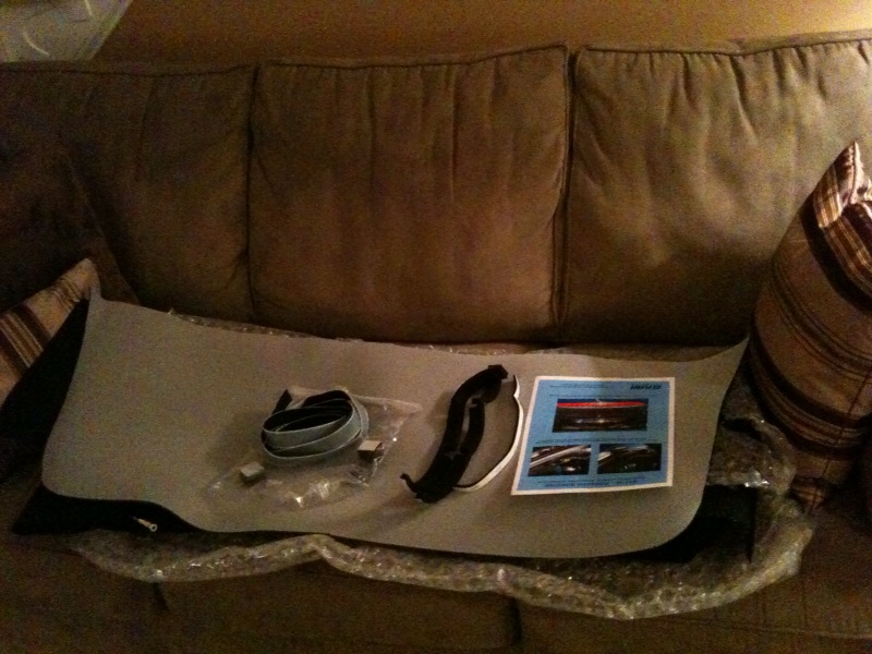

  6. confused about it's contents so I've got nearly everything ready, I ordered the entire kit because I misplaced one of the funny rubber plugs that's included along with the foam seals included is a large 3 layer piece of "cloth" that has a silver cloth side, a foam interior, and a black cloth side, along with a bunch of velcro, but I have no such piece on my 2002 S, so I have no idea where it goes, it does have a centering notch but all that tells me is that it should be centered :) here's a pic of it on a couch, (on top of the gahh roof) the 8 1/2 x 11 inch piece of paper is for size reference any help would be greatly appreciated, thanks!
