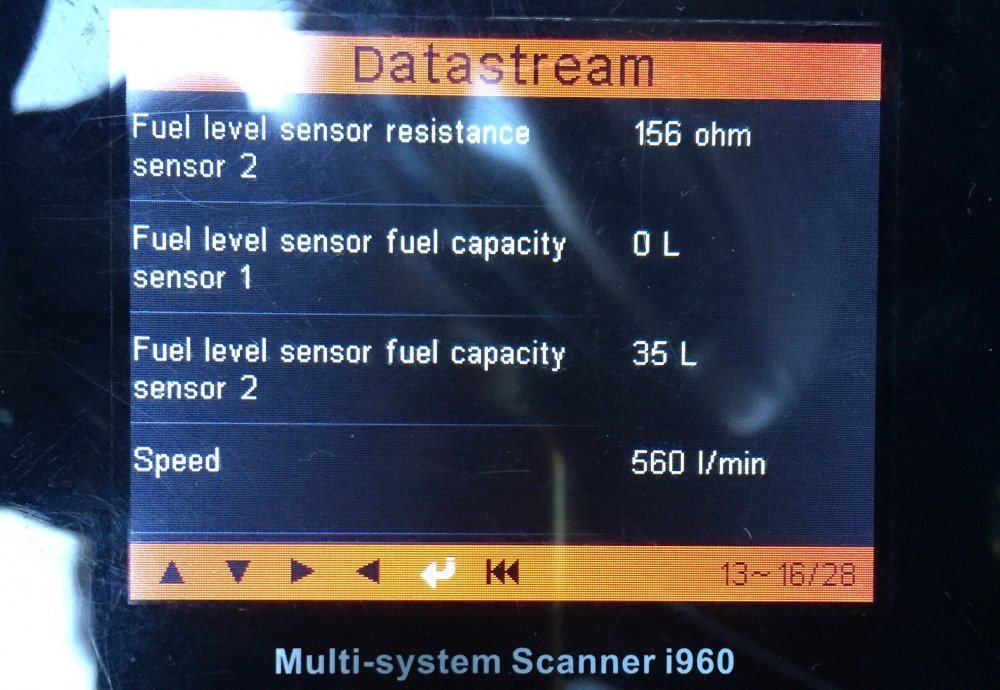

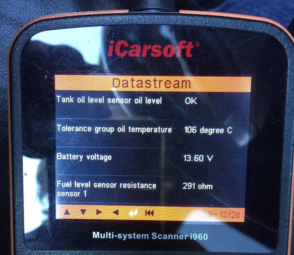

  9. Regarding the fuel pump checking i would like to ask if somebody can read the numbers below and maybe point me to something what isnt correct. Thank you

  12. i did a test this evening. Outside temp 22 degress. ICarsoft OBD Tester first of all some guys here are right. Our oil temp gauge is a toy tool. mine stay always at 90. doesnt metter which temp outside and how i drive. Measuring with the tool = 107 degrees gauge = 90 degrees water is the same : the OBD reading is always HIGHER than the gauge. I let the car idle at 570 rpm for some minutes water temp according OBD = 96 water temp according gauge = 90
