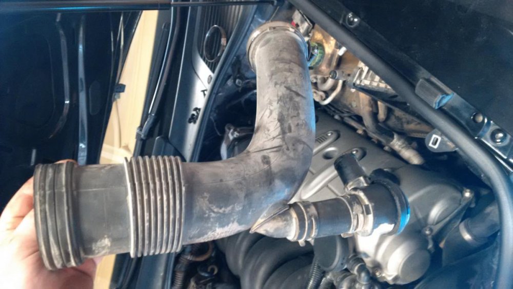

  3. Hi Mark like shown on the engine picture, after the hose which is coming out of the air filter housing, the MAF is located. Next is a tube which is connected with the turbo. This hose has some kind of junction where the DV is connected to.
  4. I know Lewis . You explain me how to do it. Is your guess the DV is causing this oil mass? i am not a mechanic and so my questions might sound stupid but i try to understand the basic things on this engine. Why a bad oil separtor which is sitting on top of the engine can be also involved in the problem i have here? Thank you for making things claer with your markings a the engine picture.

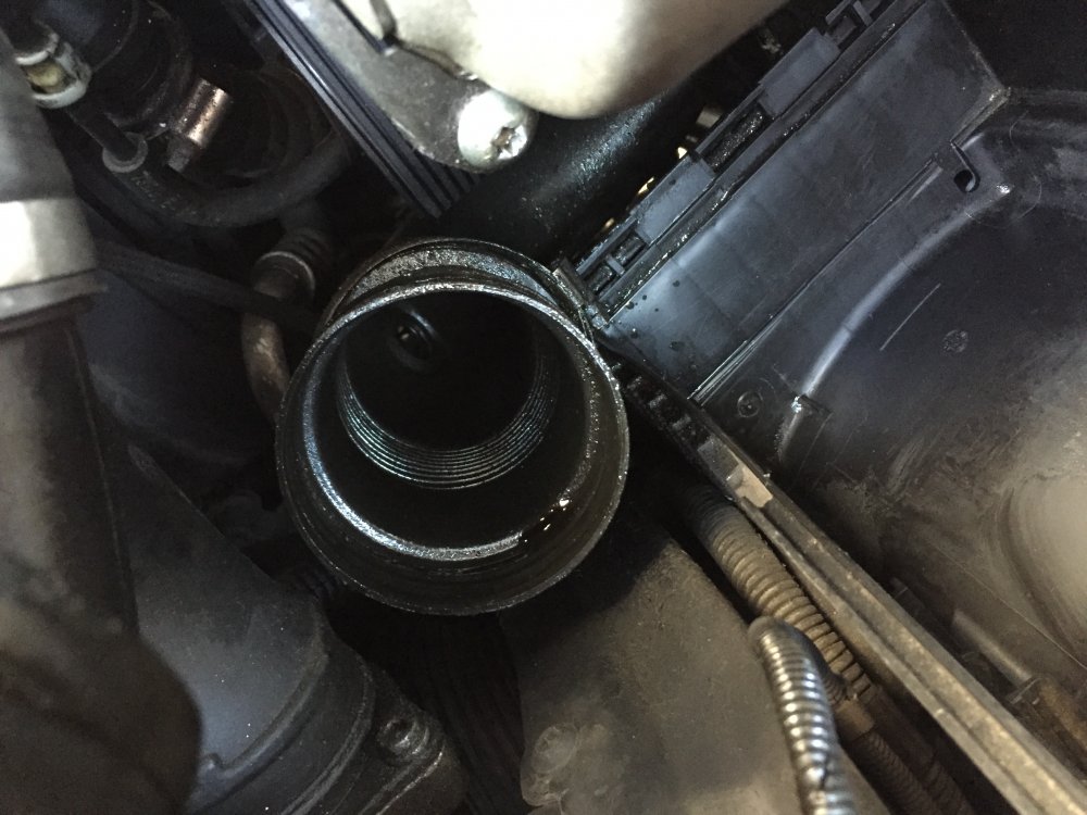

  7. This car keeps me busy. I wanted to change air filter and MAF's because the car is not running and shifting well. The procedure is easy for somebody who is handy. Biggest problem to seperate the pipe where the MAF is sitting from the pipe which is going to the turbo. if the air filter is out there is enough place to work. right side was a bad surprise for me. I had the valve cover gasket replaced some weeks ago and there is still so oil spray. I note them already . But when i had the air filter out and look down i found everything full of oil. This i guess is coming from somewhere down. i seperated the MAF from the pipe and what i saw was not nice. hose completely dirty with oil MAF swimming in oil i understand the air stream is from up to down. Air filter to MAF to turbo. what causing so much oil in this MAF / pipe. ?

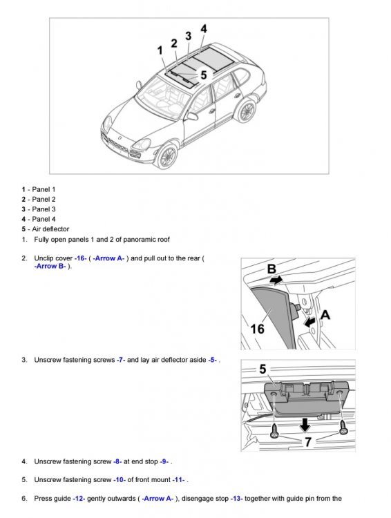

  14. I need to disconnect all my pano roof panels because the air deflector / panel 1 doesnt move. Can somebody please point me to the place where i can find the the item no. 5 shown on the diagramm. Thank you
