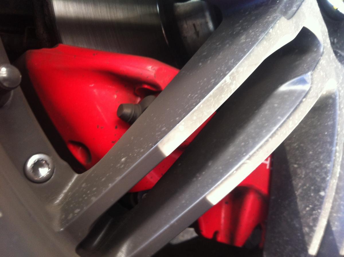

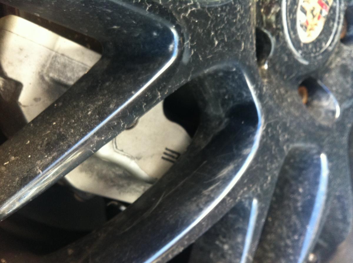

  5. Maybe someone can help. Here are 2 pictures. Caliper from my Turbo and my S. I wanted to change the wheels of both cars but i dont Know if it will fit. According my papers the BBS RX519 10,5 x 21 / Offset 52 fits to the turbo. When i have a look to the Turbos calipers i guess there Isnt enough Space. Maybe somebody knows how much more wide Are the turbo calipers comparing with the Cayenne S ones
