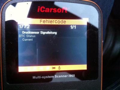

  5. I bought one of these Tools. Try it this evening. I would like to say it can do a lot for this small money. I had a lot of hidden Codes. Most of them not serious. Found out which parking sensor is faulty. Nice tool

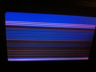

  9. I try already the search but couldnt find a post which is describing a similar problem. My car is a Turbo S from 2005. Already from the day i bought this used machine i had Problems with the PCM. Audio works perfect but the Display was showing nothing else than strange colours and signs. I was planning to send the unit to a Special repair shop soon. But SURPRISE today when i started the car and switched on Radio the Display was ok. I switched from Music Channel to Channel to navi and so on. Always a display how it should be. First time since i own this car. But when i pushed the cd Button again :-( Strange display like Before . Maybe somebody can give me a hint whats going on here?! Thank you

  11. As i understand you can reset Codes but not the Service Light ...... Thats what i found: The system offers total diagnostic coverage of all engine, chassis and body systems Reading and re-setting of diagnostic trouble codes (DTC) Real-time reading of dynamic data Full component activation clearing and re-setting of adaptation values Coding of all engine, chassis, body and instrumentation modules Will not reset oil and service meter. Key configuration 1 Year Product quality Warranty Free online software update within 1 year of purchase. The i960 can live data during the operation of reading. Will Not Reset Service Light Indicator. The live display of sensor data is switchable , so that all relevant Data are presented in various displays, such as for example: - DME, ECU - Tiptronic - Airbag (SRS) - PSM - KESSY - Air conditioning - Instrument Panel - gateway - Electrical wiring - parking sensors - And many more - Temperature of the aspirated air - Air mass / air flow - Engine speed - Vehicle Speed - Position O2 Sensor - Coolant temperature - Slow correction - Fast correction

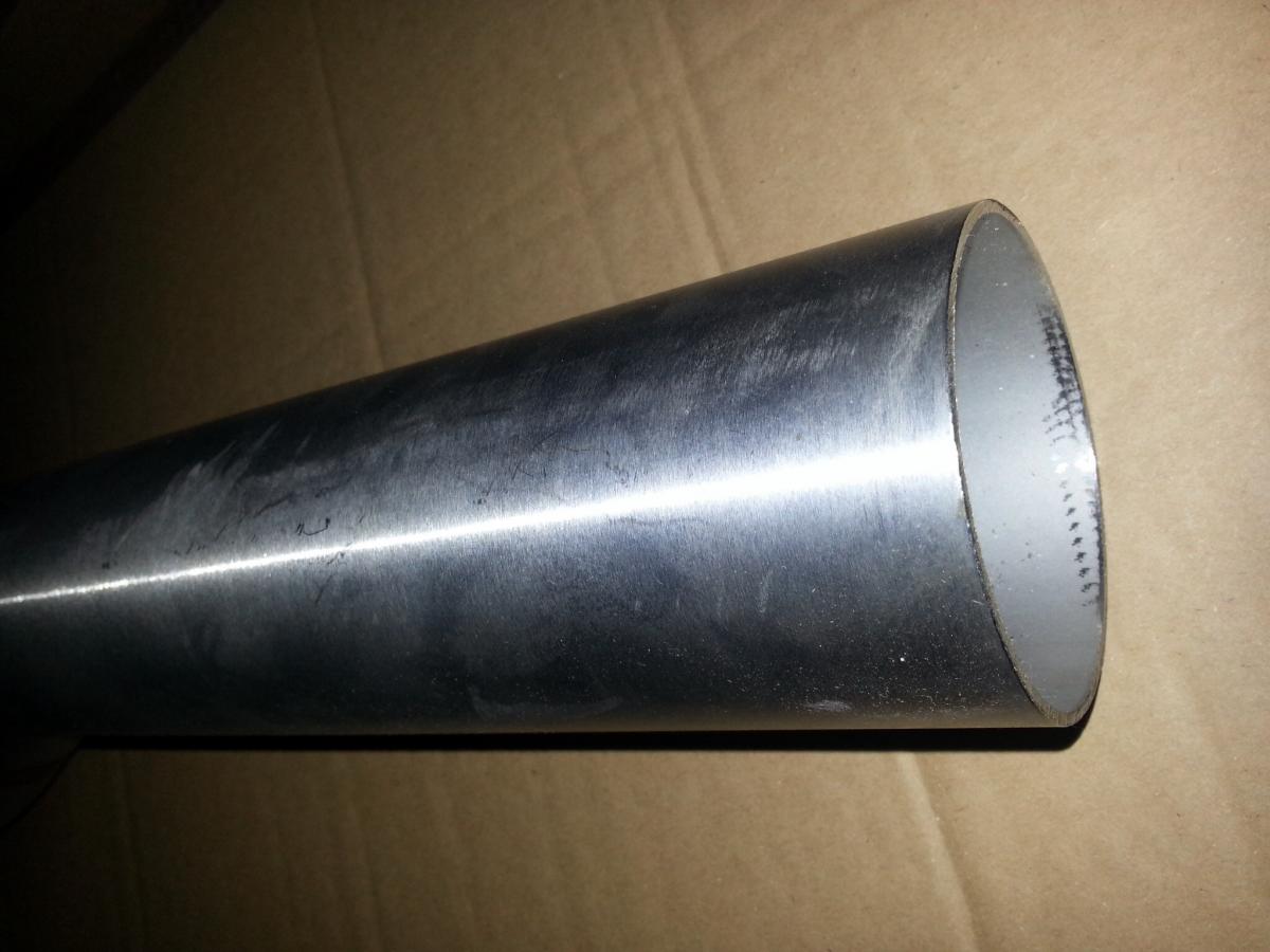

  14. Thank you. Its not about the clamps. The Problem is the the pipe tips are 70 mm and the connection pipe from the muffler is 70 mm too. You can not telescope the parts.

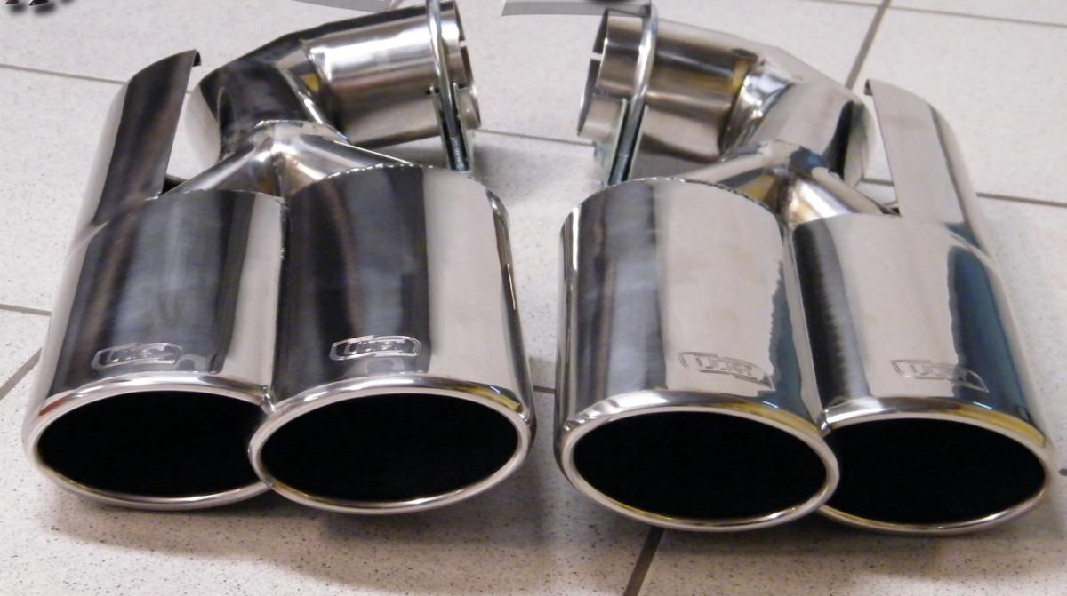

  15. I have a exhaust muffler for my turbo which i want to install. I would like to try to do this job by myself. There is just one question open and i would like to ask your advice. The exhaust Pipes are 70 mm in diameter. What is the diameter of the original Pipes? The rear end pipe tips are 70 mm too. What would be the best way to connect them? Thank you !!!

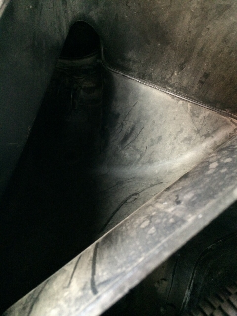

  16. I realy dont know. But for me it looks strange that there is a big access to the cabin.

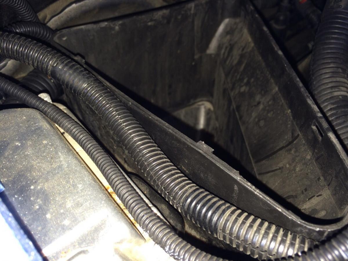

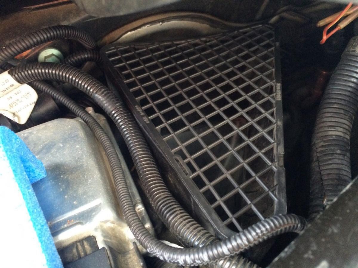

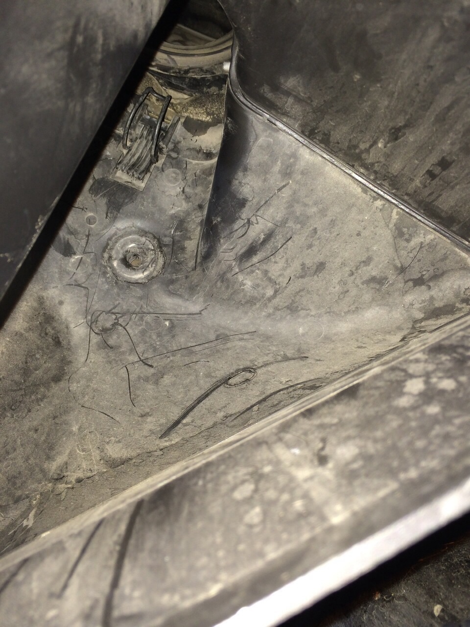

  17. Hello everybody! I am still observing the frequent water Problem i have. Passenger side under the plastic trim, close to the ECU is a Black Container / Reservoir . I took away the cover and found there a drain hole. But i also found a very big hole which is a Passage to the cabin. This should not be usual. I try with a Cup of water what is going to happen. Of course the water came directly to the carpet. For shure there Must be a closing mechanism which is missing here. Your advice is welcome. Please check the pictures.
