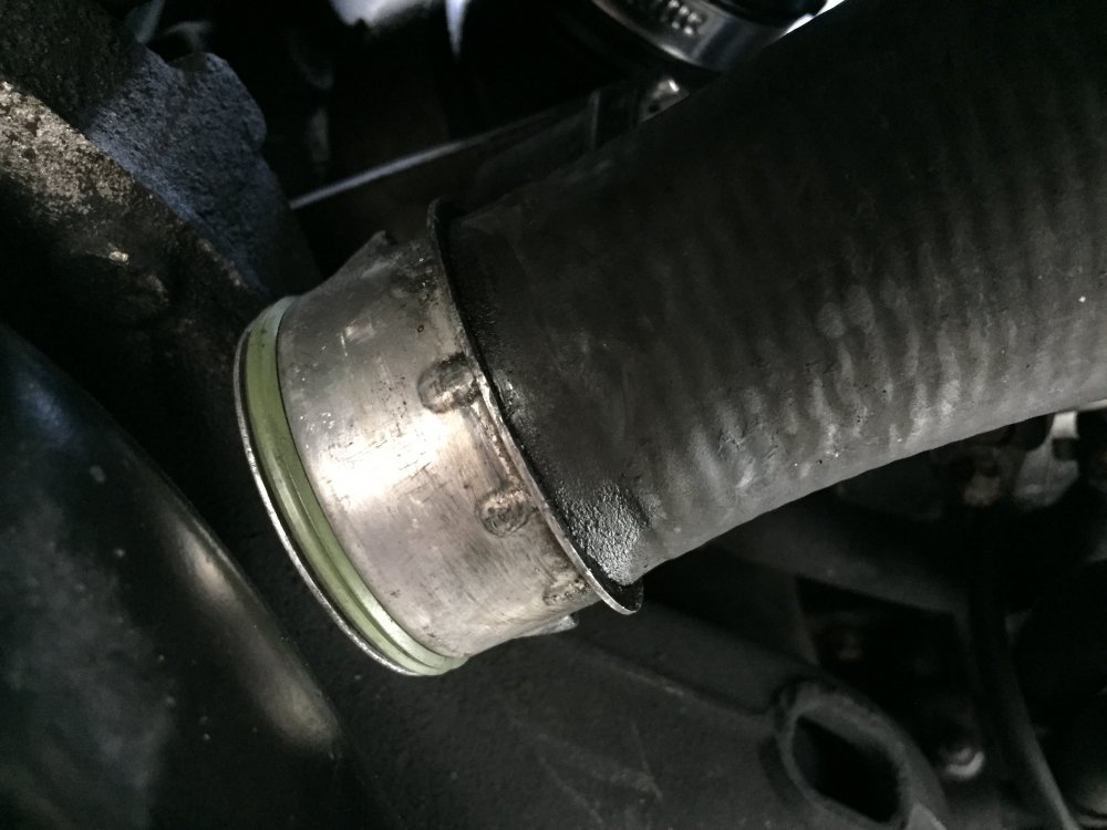

  12. On the way to find the leak i change the Turbo Charger to Intercooler Hose Seal / passenger side / which is sitting next to the Charger outlet. Was easy. No oil inside. Testdrive. The same. Wastegates not possible to reach from underneath and not through wheel housing. test drive. Noise still in place.

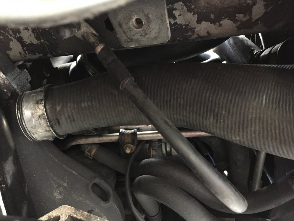

  14. replaced the passenger side pressure pipe which is going to the wastegate. Was only one year old but i wanted to be shure there is no leak. Checked the hose to intercooler, hose to intake where MAF is sitting. Everything tide. Wanted to check the wastegate mechanism but difficult to get to this place. maybe somebody can route me how to come to this place?!

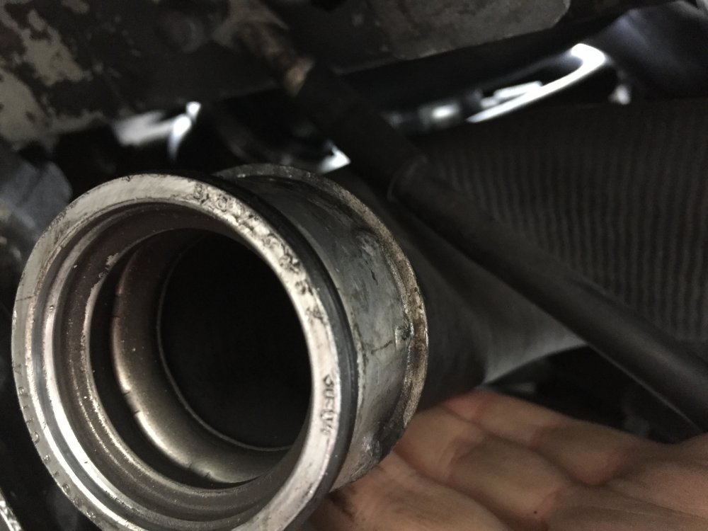

  16. Picture is not good. Take out the Y - pipe checking for cracks. Looks good but ..... oil inside
