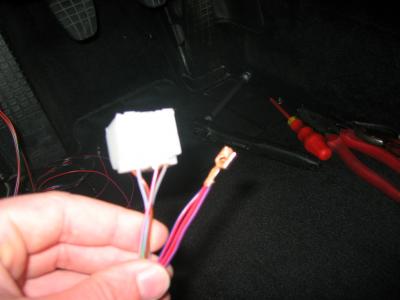

  2. I have tried again, it wont fit , strange! My connector is in 2 pieces, one outershield and one smaller inside where the wire is fixed, shall I remove the outershield? I have removed the grey plastic thing It will fit like the other connectors, right ?
  3. Piece of Cake! The fuse box has a carpet cover on it that is held on with 4 screws. Take the black cover off to expose the fuses, and you will see the 4 screws. Take them off, and pull off the carpet cover. The fuse block is held in by 4 clips on each corner of the box (block). You can see 2 of the clips in this picture. Just pop the clips free and pull the fuse block free so you can get at its backside. Here is a picture of fuse box mount with the clips. I have already pulled off the fuse block. Crimp and or solder a female spade connector onto the red/blue wire that will be attached to the fuse block. Turn the fuse block over and insert it in an open spade where my finger is pointed. As you can see, I have already attached my red/blue wire there. (2nd row, outboard connector) That is it! Now put everything back and you are done. If you have not already installed the relay plug on the relay support bracket, it is easier to get at with the fuse block detached. Thank you for your replies I have detached the fuseblock and turned it over and it is a free spot to put the wire in but it wont fit! Here is a picture of the connector. It is a grey plastic thing halfway down, can I move this one? Is this the right way to connect the wire? In the Technical Info from Porsche it says that you should crimp it to the BK/RE wire for fuse B10. In your picture it seems that the RE/BU wire is not connected to the fuse becouse the power source is on the same side as you have connect the wire. Right or wrong? /Magnus
  4. Thank you You are right about the wires, the 3 wire Red/Blue bundle comes with 1 wire from the switch and are connected together as the picture shown and goes back with 2 wires, one to the back of the car and one to the fuse box. How do I split the fusebox? And the big question How do I connect the wire to the B10 fuse?
  5. It´s a 996 Here is a picture of the wire with the 3 wires into one connector, in the background you will see the other red/blue wire Is it a diffrent Technical Information for the latest PSE xxxxxxx21 or is it the same as for xxxxxxx19 /Magnus
  6. It´s a 996 Here is a picture of the wire with the 3 wires into one connector, in the background you will see the other red/blue wire
