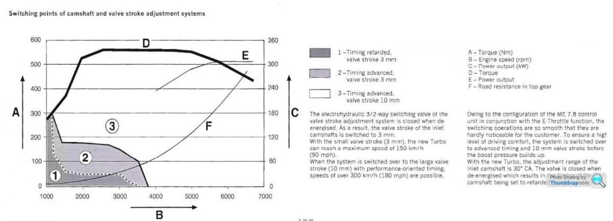

OK, thanks. I found this in reference to the 996TT switching points and wondered if it applies to the NA motors and/or changed with the newer models in general. I was trying to figure out if the switching points are purely engine speed based or also a function of load. Anyone have a similar plot a NA vcam+ motor? I'm a bit envious of those with older models as the available information seems much greater. I would love to have the correct ohm readings on hand.
