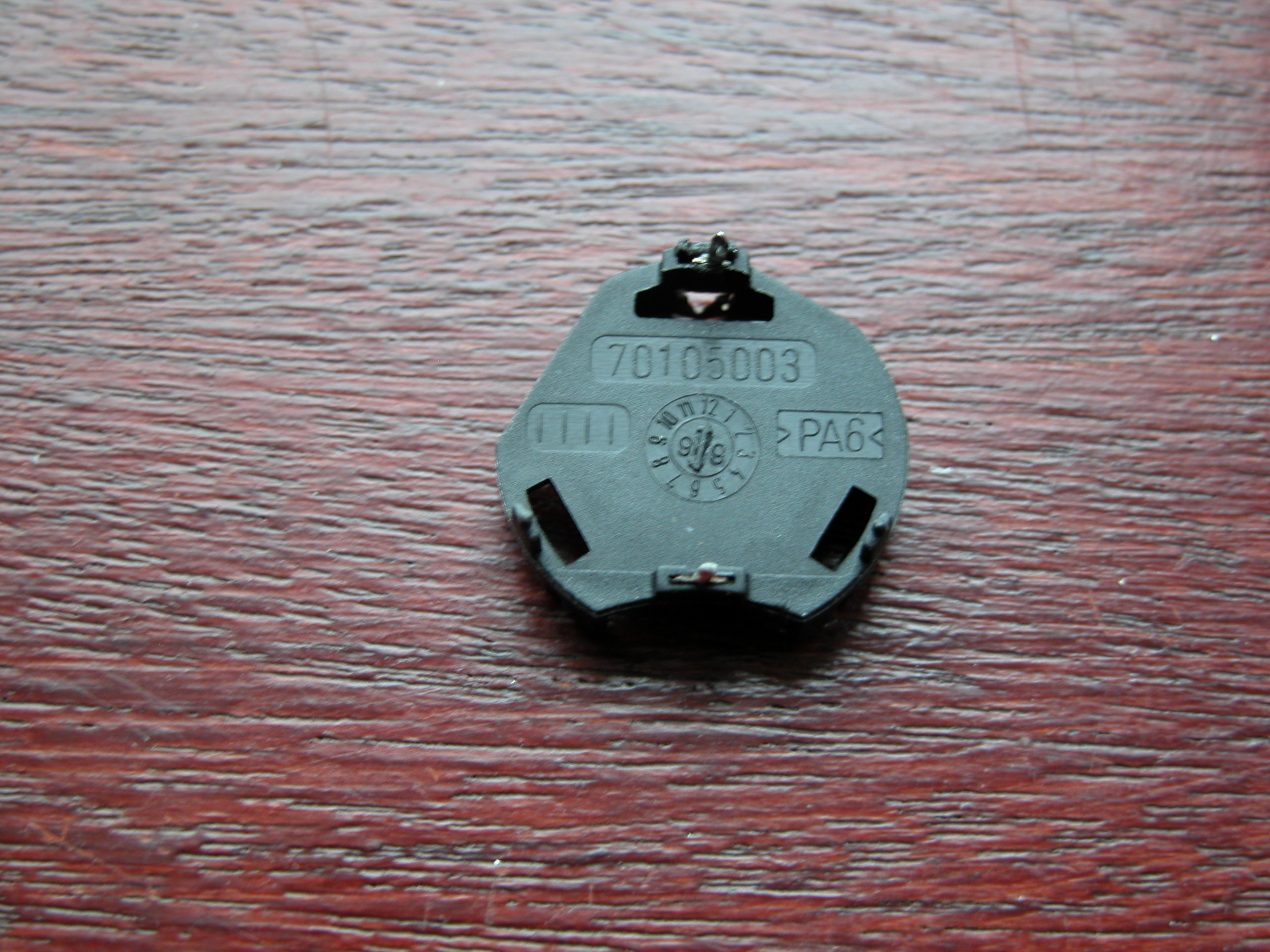

  5. Hi Dave, many thanks for the info. Do you know who makes the battery holder? The number on the reverse side is 70105003 (see pic) W
