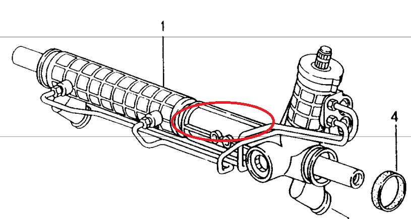

  1. To answer my own question and help anyone else who is searching: the rack part number is stamped on the part and is clearly visible without removing it from the vehicle. I was finally able to get under the car. After removing the center cover, I could see the part number on the back of the unit (towards the rear of the car) and just to the right of the input shaft. It's on yjre side opposite that circled in the picture above. After scratching the funk off it with a wire brush, it was easy to identify the part actually installed on the car so I could order the right boots and clamps on the first try.
  2. At this point, I'm thinking my question wasn't clear enough. What's important to me is discovering which rack is in the car. If I buy parts based on what rack should be in the car, I'll get parts that should fit. What if they don't? If I buy parts based on the rack that actually is in the car, I'll get parts that will fit. I'm hoping to find a way to identify the rack that actually is in the car. In this project, I've already been burned by VIN lookups that resulted in purchasing the wrong parts. It would be great if I could get the right parts on the first try because doing so will save time and money. Maybe the rack has a part number cast into it, or other identifying stamps, that will let me know with certainty which parts to buy. Or maybe I can measure a certain diameter or length and know for sure which bellows and clamp set I need.
  3. Problems? What do you mean, specifically? The VIN is legit -- I've owned the car since new.
  4. Any advice on how to make that work? I start here, then enter my VIN in the search box (which says Part number(s), Keywords or VIN) and I'm told my VIN is not found -- as if it's searching the parts catalog for the literal string of my VIN. I was hoping there was a known spot where the part number was stamped into my existing rack, or some other physical attribute that would help me know which supporting parts to buy.
  5. I have my 1999 Carrera 4 Coupe. About 98000 miles. I'd like to rebuild the front suspension, including the inner and outer tie-rods. I'll need tie-rods and boots, plus the retaining rings and that sealing ring. Looks like there are a few different parts for the steering rack, which must be different sizes or shapes because the related parts are different. The Katalog I have shows 996 347 011 05, plus -06 and -07 for the rack. Looks like -06 and -07 require different external parts. How can I tell which steering rack I have? Is a part number on it in a visible spot or can I measure something to figure out which bellows, clamping ring, and sealing ring I need?
