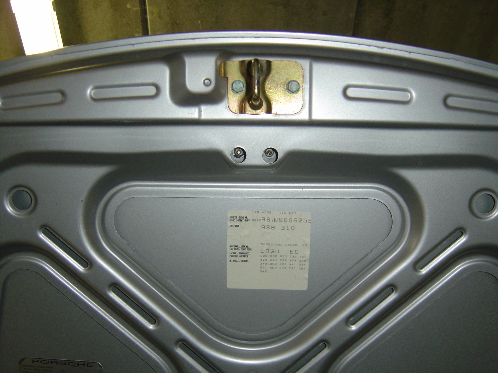

  16. Hello, Does anyone know what following (option) codes might mean on a 2.5L Boxster (European version) with Manual transmission ? (see also attached picture of the option code label) C00 M232 The car has also : option code M013 which calls "Sport Technik package". What does it stands for. In the parts list I cannot find any parts related to it. (The sporty suspension parts i.e. struts, springs and shock absorbers are covered by option M030) option code M224 which calls "automatic limited slip differential". What does it stands for ? Mind it is not a Tiptronic car ! In the parts list I found that it is related to the ABS unit only. Is this probably in combination with TC (M222) only, although the restriction is not visible in the parts list either? Thanks for any reaction, Alfred

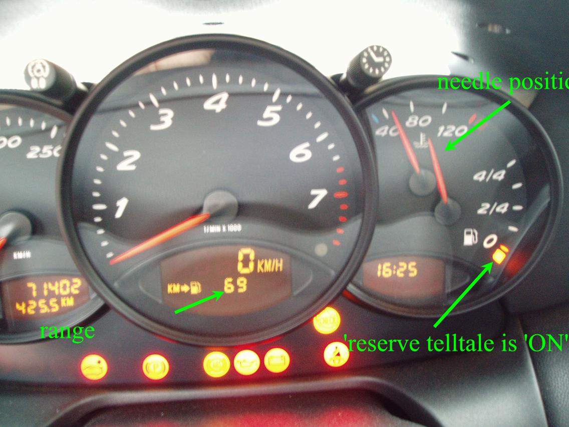

  18. Hello Loren and other forum members, My fuel gauge problem is not solved yet. I attached a picture to explain what happens : - the fuel gauge needle stays beyond the 'FULL' mark. When turning the ignition on then the needle starts to jump up & downwards some mm's and then remains above the 'FULL' mark. - the board computer seems to work fine since the 'RANGE' follows the content of the fuel tank. - when the fuel tank is nearly empty, the 'RESERVE' indicator telltale lights up. This makes me believe that the fuel gauge is working correctly (I already measured the resistance with the tank full and nearly empty and this seems OK to me). Replacing the instrument did not help either. Do you think that a calibration with the PST2 would cure the problem taking into account that the OBC and the 'RESERVE'telltale work correctly? Additional information : 1. All other functions of the instrument panel work fine. 2. with the Durametric Diagnostic Tool I have no access to the instrument panel although I can communicate with all other computers (ABS, engine, HAVC, alarm,). Therefore I rather suspect a ground or cable problem. Any useful hint would be welcome ! Thanks Alfred

  20. Hello Loren, Toolpants, My fuel gauge seems to be defect. I have a spare cluster with speed indication in miles instead of kilometers. Do you think it is feasible to replace the NOK-fuel temperature gauge and the fuel gauge by an OK-one separately, since I think they are similar on both versions. I saw a picture of a dismantled cluster somewhere else on the site. Is the dismantling self-evident and can I find somewhere a description with fotos or pictures ? Thanks, Alfred
  21. Loren, I read in the shop manual that a calibration of the fuel level sensor might be necessary wit the PST2 or PIWIS when the battery, cluster or fuel level sensor have been disconnected. Unfortunately this feature is not covered with the Durametric Tool... Is it possible to arrange a so-called 'manual self calibration' i.e. by filling and driving the fuel tank empty repeatedly or disconnecting the battery at a certain fuel tank content ? Regards, Alfred
  22. Loren, thanks for the quick response. I'll check the fuel sensor tomorrow. I found some 'Ohm-values' on a German Porsche website. But I still wonder why the needle stays activated with ignition 'off'. There is a company in Germany which is specialised in repairs of ECU's and Instrument clusters. In the worst case I have to send the unit to them. Nevertheless if you or somebody else has a hint, then I would appreciate to hear it. Regards, Alfred
  23. Hello, As from today my 2.5L Boxster's fuel gauge started spinning. The fuel gauge needle jumps from one side of the gauge to the other side. This morning when the fuel tank was half filled the needle indicated O liter (fuel tank empty), when turning the ignition off the needle went to 1/4L. Again ignition on and the needle stayed at 1/4L. After filling up the tank it became worse. The needle just climbed up until it touched the temperature gauge needle...! When turning the ignition off and on again I took some pictures (see attachment, these 5 pictures were taken in about 30 seconds). I did not check anything yet. I only disconnected the battery to 'reset' the instrument but this did not help. The needle never returns to '0' when turning the ignition off. Has anyone experienced such phenomenon and can you give me a hint to find the root cause. Is it possible that a poor mass connection causes this problem? (I doubt it because all other functions of the instrument work fine, also the measured distance to go and also the average fuel consumption seem to work as the temperature gauge does). Thank you for reactions, Alfred / Belgium jumping_fuel_gauge_needle.PDF
