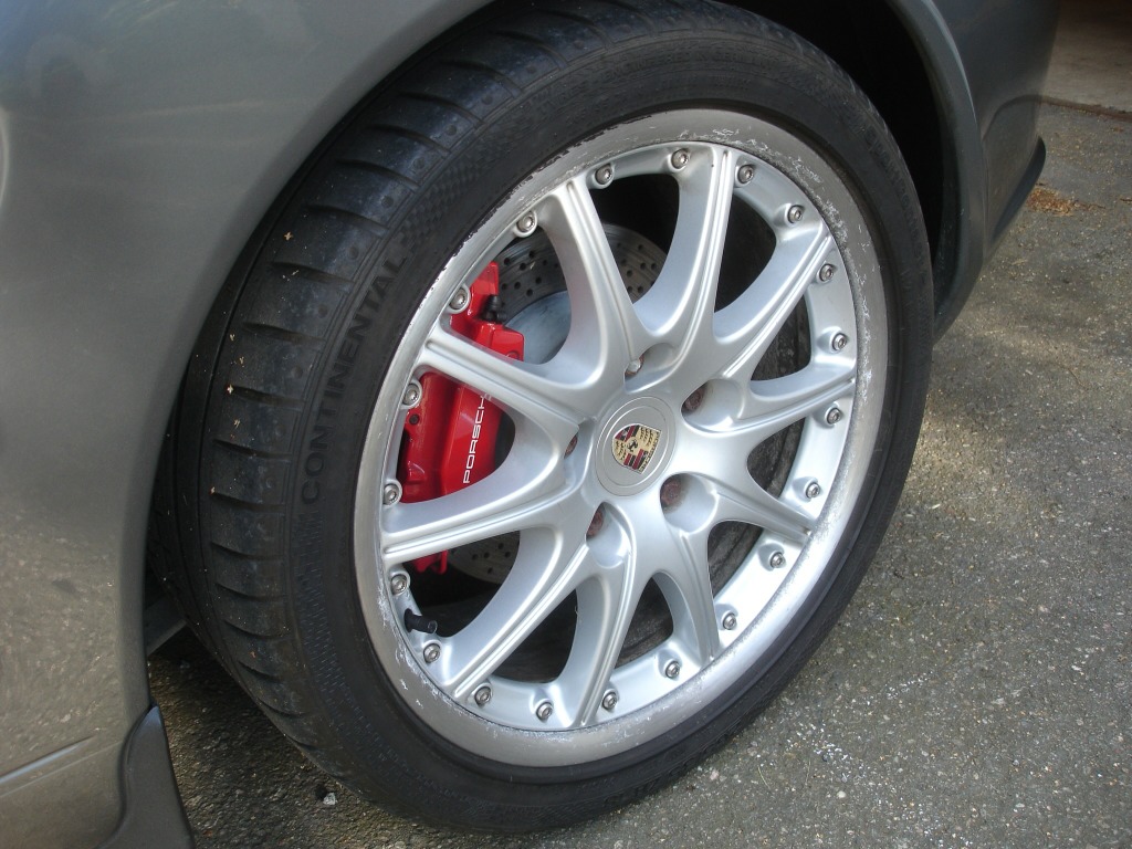

  12. and can the wheels be restored? Looks like oxidization UNDER the clear coat...
