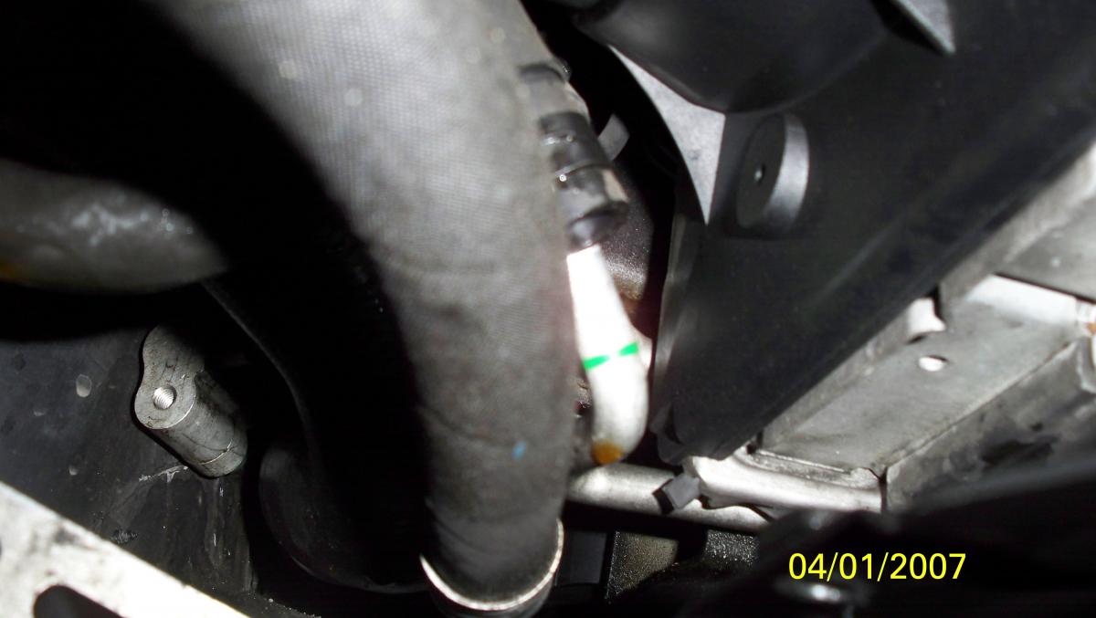

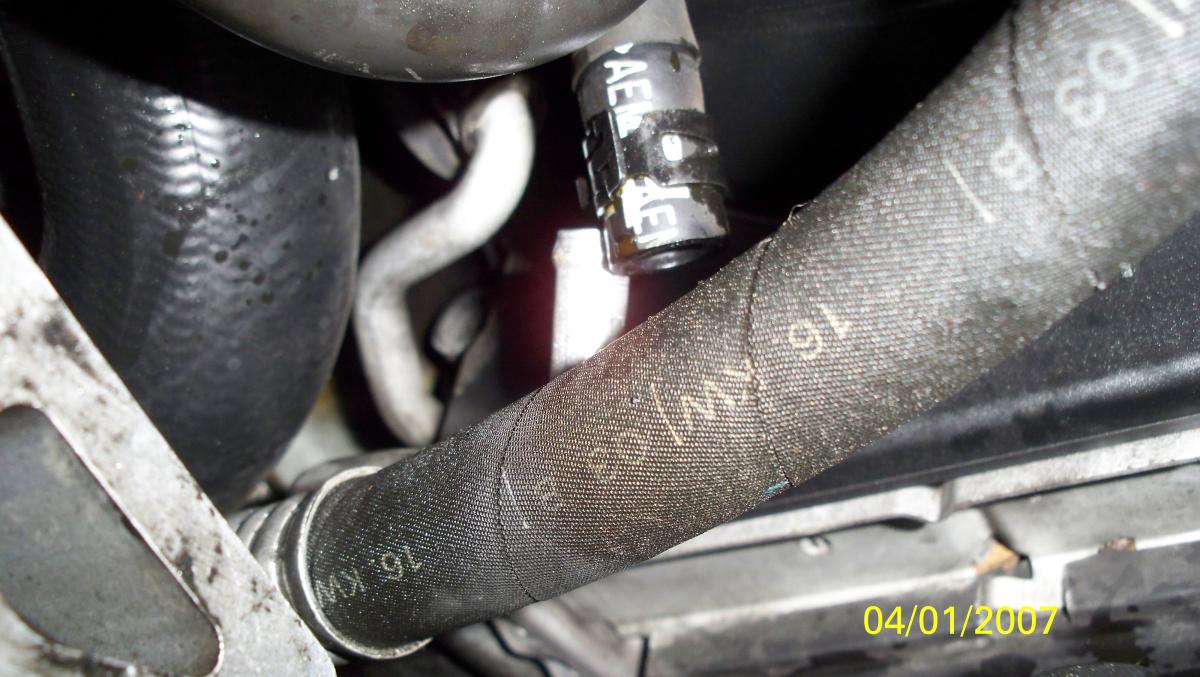

  22. Found oil on floor....which lead to finding drips on lower shroud. Was thinking it was more power steering leak but fluid was green. Engine had not been run for 24 hours but was able to see bubbles on the casting of the AC unit. If it was not bubbling would never have seen the crack. Lucky it was not on top or on a side. What could lead to this casting crack? Can I order a replacement compressor and have a generc shop evacuate and refill with 134 after it is installed? What is the best course of action? I can not drive it to a dealer as I am over 200 miles away and I believe that when all of that PAG oil leakes out of the compressor it will seize. And thats a problem on vehicles with serpentine belts. I miss multiple belts as one can make it home by cutting the belt connected to a seized ac. I will probably be nominated to replace this ac unit...I see it appears to be kinda close to get at...difficult to remove / replace...any tips..advice appreciated. Trying to post pic but says it is oversized even though it is under 2 megs. Will try adding. Thx, John
  23. Wanted to update this. Was as simple as a hose clamp. Apparently lots of vehicles up here have cold weather problems with viscosity of power steering fluid. Was instantly reccommended to use ps fluid that was more friendly in cold weather...explained that I couldn't due to porsche weirdness. Motherinlaws cadillac suv popped its ps line couple of days later. I have had to arm strong plenty of vehicles and am old enough to have had several vehicles with no power steering. Never were this difficult to steer without PS. That rack and pinion is very tough to move even with vehicle moving. Yes I know it is strongly frowned upon to drive without fluid in pump. But with 4 year old and -15 degrees and very rural...sometimes you need to just get home. That is what I need in a truck...one that gets you home.
  24. Crud.....The line number is 22 with clamp # 23 NOT 17 and 18
  25. Thank you for diagram. Pulled lower cover. Looked up in there to see hose 17 seperated from oil cooler at banjo 18. Banjo attached to rubber line. No apparent stress. Here is what happened: Drove car and everytning fine. Parked it for 2 hours in -15 degree weather. Started it and drove off. Discovered quickly that very hard to steer but could muscle it. (barely) Wife and four year old in car had to get it home. Drove it home 8 miles and got it in garage. Where it leaked a 24inch puddle. I floor dried the puddle. I restarted it next morning to listen for any pump noise heard none and watched it spin...quickly shut it off. Got call from owner of driveway that car was parked and was reported to have big oil dump. Had to leave town for almost 3 weeks. Now I am back trying to figure this out. Any reason that line 17 would seperate at clamp 18? I initially thought maybe water somewhere split a line. This looks more like the hose was pulled off the line. And the aluminum line to the cooler is lower and would have bulged or split just below the connection if water froze low in line. Now wondering if a pump or rack issue could possibly have caused anough pressure to pop the line appart. Looks like this is a return line from the oil cooler back to the fluid reservoir up by the battery jumper posts. Pic 850 shows the rubber line just as I found it off the silver hard line with the green mark. That hard line is the lower line off the oil cooler. Pic 847 shows the connector and line just as I found them. I used pliers on the clamp and slid rubber back on line to the mark and clamp reseated on the correct side of the flair. I have had armstrong power steering in my '76 dodge van with three on the tree. Once you get moving in vehicles without power steering they get much easier to steer which is why I know to always move some if doing any steering as its hard on everything including tires. This Cayenne was not easy to steer at any speed without power steering. Very difficult. Maybe that has a bearing on this line or not. Could I be lucky enough to get fluid tomorrow (if local NAPA or anyone actually has the stuff) and fill up and have everything work fine for 100,000 miles? I am 200 miles from Porsche so must do repairs like this on own. Need to find a manual. Or online manual. Advice on best way to get a manual? Thanks, John
