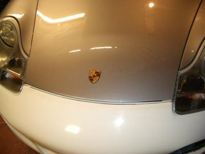

  12. Hi there i am just doing a complete make over on my 996 C2 non facelift model, Here are some pics of the front turbo bumper. This is a MASHAW one i bought off someone from the porscheclubgb forum. £200.00 It took a while to adjust it as the front top section just under the bonnet Sorry (hood) is fully adjustable to get the bumper to line up correctly with the said hood. Anyway good luck. Steve UK

  16. Hi there stan. The exact amount is the strip you can see in the photo,s. It is 30mm I.E 15mm each side of the centre line. Will be getting the lot painted soon , Just finishing off the side skirts then all off to paint shop. Thats a none oem front bumper. Genuine rear TT bumper, Side skirts none oem, & lastly the huge MASHAW rear wing come lid. I must say i am a bit of a cheapskate as the whole thing has not cost very much. £80 rear bumper e-bay. £200 front bumper porscheclubgb member, £300 rear lid porscheclubgb member & £165 side skirts e-bay. Oh & a pair of used silencers to modify £19 e-bay. Not sure how much painting will be though, probably quite a lot. \cheers. Steve UK
