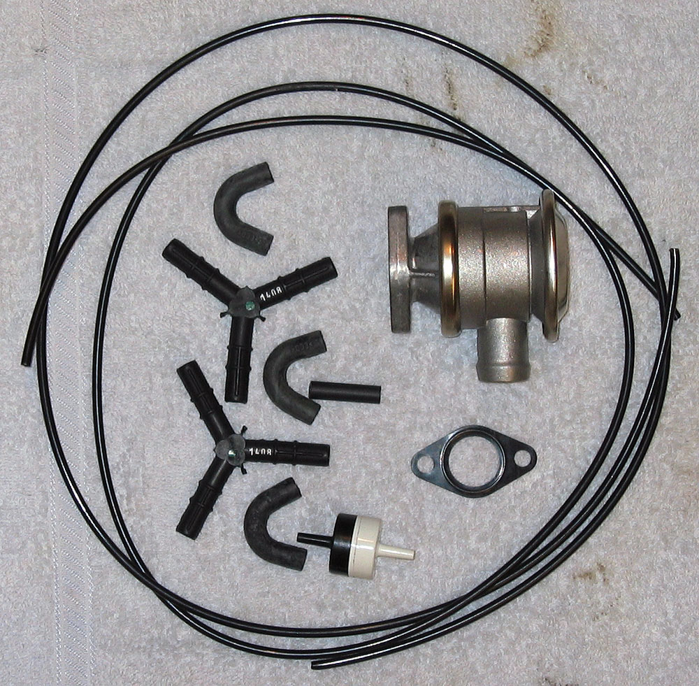

  2. Yes, you can just pull it off. It is part off the vacuum system and connects the check valve to another of the small "Y" tubes as the bottom of the vacuum reservoir. Attached pictures shows mine removed and parts for the vacuum system rebuild and shut-off valve replacement I will be doing this weekend.
  3. It's handy to know that this type of vacuum line in called Teklan. While the Porsche Catalog does not list a Porsche Part number for it, the line I picked up from Fletcher's had part number: 000-043-205-01 While you never know, I doubt I would pass smog with the P0401/1411 CEL on my car since it is not an intermittent problem. Even after I clear it, the light returns again very quickly. Unfortunately, replacing the electronic change over valve did not fully fix my problem as I still have code P0401. I have ordered the air shut-off valve and some additional fittings to complete rebuilding the vacuum system.

  5. Part 2. Vacuum system: The typical diagram (attached) does not really match my car (2001 Boxster). You will find two “Y” connectors instead of one. The lower connects directly to the vacuum tank with one arm of the “Y” going to the second “Y” and the other to the Electronic Change Over Valve. If you have oil on the vacuum lines, then you should replace the rubber protective tubes (what the stiff vacuum tube pushes into.) These expand when in contact with the oil and may no longer hold a vacuum. Rant: Went to Steven’s Creek Porsche (Santa Clara, CA ) to buy some of the small diameter, stiff, vacuum line since I broke one of the sections. The person running the parts desk said he had never seen vacuum lines like I was describing (the lines are shown in the Porsche Catalog, but without a part number) and wanted to sell me the larger, more flexible line. A second person working parts backed him up saying they had never seen a vacuum line like that before. Next I called Fletcher Porsche in Fremont, who said they had a meter of it in stock. I’m finished with Steven’s Creek. Last week a bought a lower hose clamp from them for my AOS replacement, and they changed ~$8 for the same clamp that Sunset Porsche charges ~$2 for. Rant Over.
  6. No, the secondary air pump is working great. My car is back together and running again so I thought I would post some more pictures and observations. I'll post these in three parts due to the picture size limit. Valve Replacement: First of all, replacing this valve is a bear the first time around since there is very little space to work in - - - 2nd time around will definitely be faster. I have attached a picture showing the valve removed. Notice the swollen rubber connectors and small section of broken vacuum line - - - more on that later. Looking at the picture of the valve going in, you can see the fixed mounting tab that it slides onto. This takes a lot of effort due to the cramped space. Notice the locking tab at the bottom of the valve. To remove the valve, you must locate the tab and push down (or in my case, and maybe an easier way, it broke off), and you must remember to push your new valve all the way on until it locks in place. Alternator: Getting this back in is significantly easier if you use a press or C-clamp to drive back the sliding nut/lock back a small amount (see circled area on the photo).

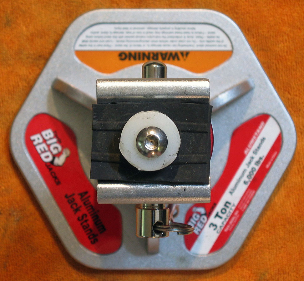

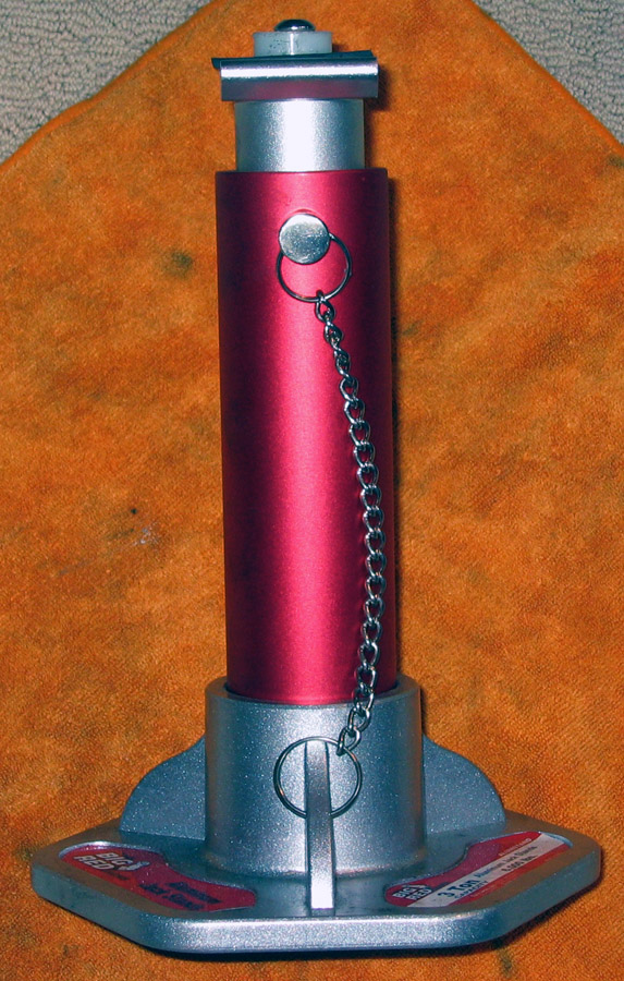

  9. I use the same jack stands as Loren - - - with a slight modification. I drilled and treaded the top of each jack stand and screwed in delrin inserts that fit the slots of the cars jack points. You have to me more careful when lowering the car down to ensure they are centered, but it is a very secure system.
