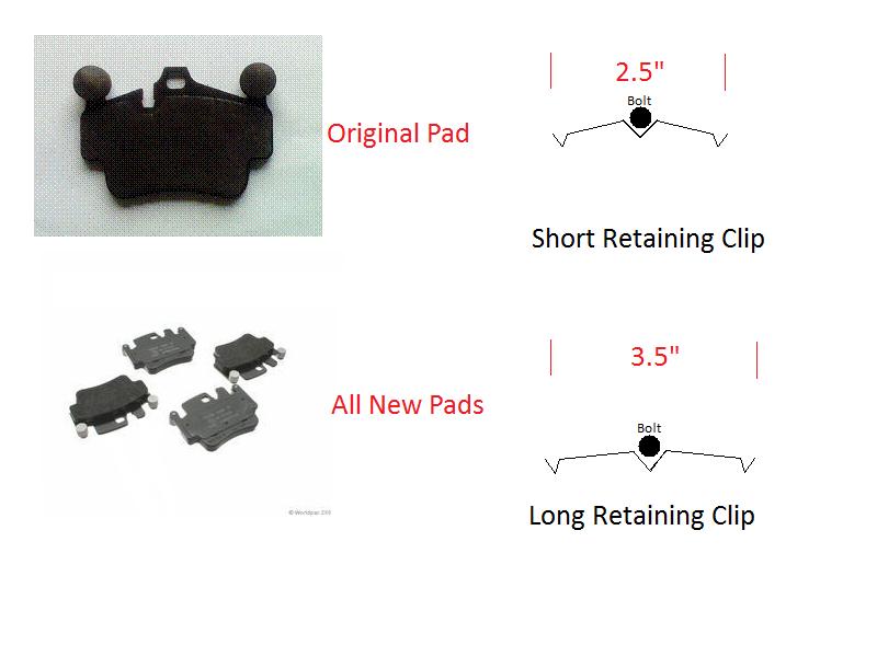

  1. Loren: Seem to be getting to the bottom of it. The pads that came with the car are the new style. The cross references of some of the aftermarket pad resellers do not seem to have recognized this new style yet. They want to supply the older style that will physically fit in but would require a different retaining clip. I'm just trying to find regular quiet street pads (I have Pagid Yellows for track and these are correct style) May just have to get the Porsche pads from the dealer. Can't find a less expensive Mintex or Textar cross yet. Thanks for the help. Dan
  2. Loren: Thanks I think that the part# on the original pad is 997.351.930.05 The BOLD numbers I have high confidence in reading. The rest were totally or partially worn down by the brake piston contact (but maybe 997.351.939.05.) The 997 is completely missing. Tried 996 986 987 prefix but got no where. Textar calls it T4045 FF Thanks Dan It would be easier if you gave me the part number on your new pads.
  3. 11K Miles. HOWEVER I put 9 or 10 DE track days on the original pads. The last event that I ran, I bought some Pagid Yellow pads which were really great. Can't complain except in trying to figure out exactly what I have. The original pad has a Textar T4045 FF number which their site says is a 997 part. Maybe 997.351.930.05 Can't seem to find much more about it. Strange.
  4. Thanks Loren. Can you tell if my "old" original pad is the "new" style? Or is it the style that was replaced? I did call my dealer and the service and parts guys did not have a clue what I was talking about. Dan
  5. I have what is becoming a quite mysterious problem in replacing my front brake pads on a very early 2007 987S. (Sept 06 build) Attached is a jpg showing the original front brake pad that came with the car and a photo of new pad sets. As can be seen, the top of the pad backing plate is different. The retaining spring clip that came with the car is 2.5" long and works just fine on the old pads. It will not work on the new style pad. The new style pad requires a 3.5" long spring clip in order clear the new raised portions of the pad backing plate. All other 987S that I've seen use the new style pad and clips. I can't find any reference to the style of pads or short clips that were built with the car originally. Any ideas what I might have and does anyone know the correct part# for the 3.5" long retaining clip? Thanks Dan
