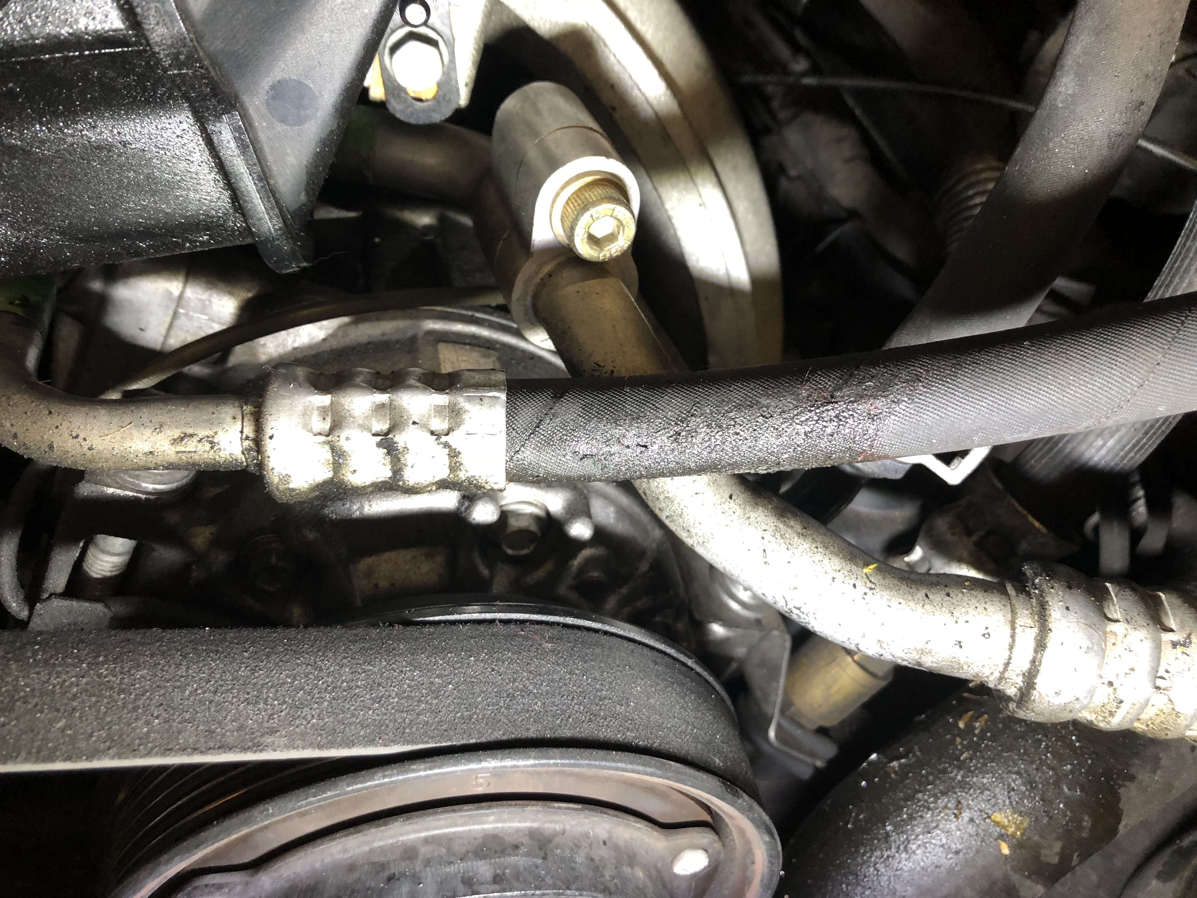

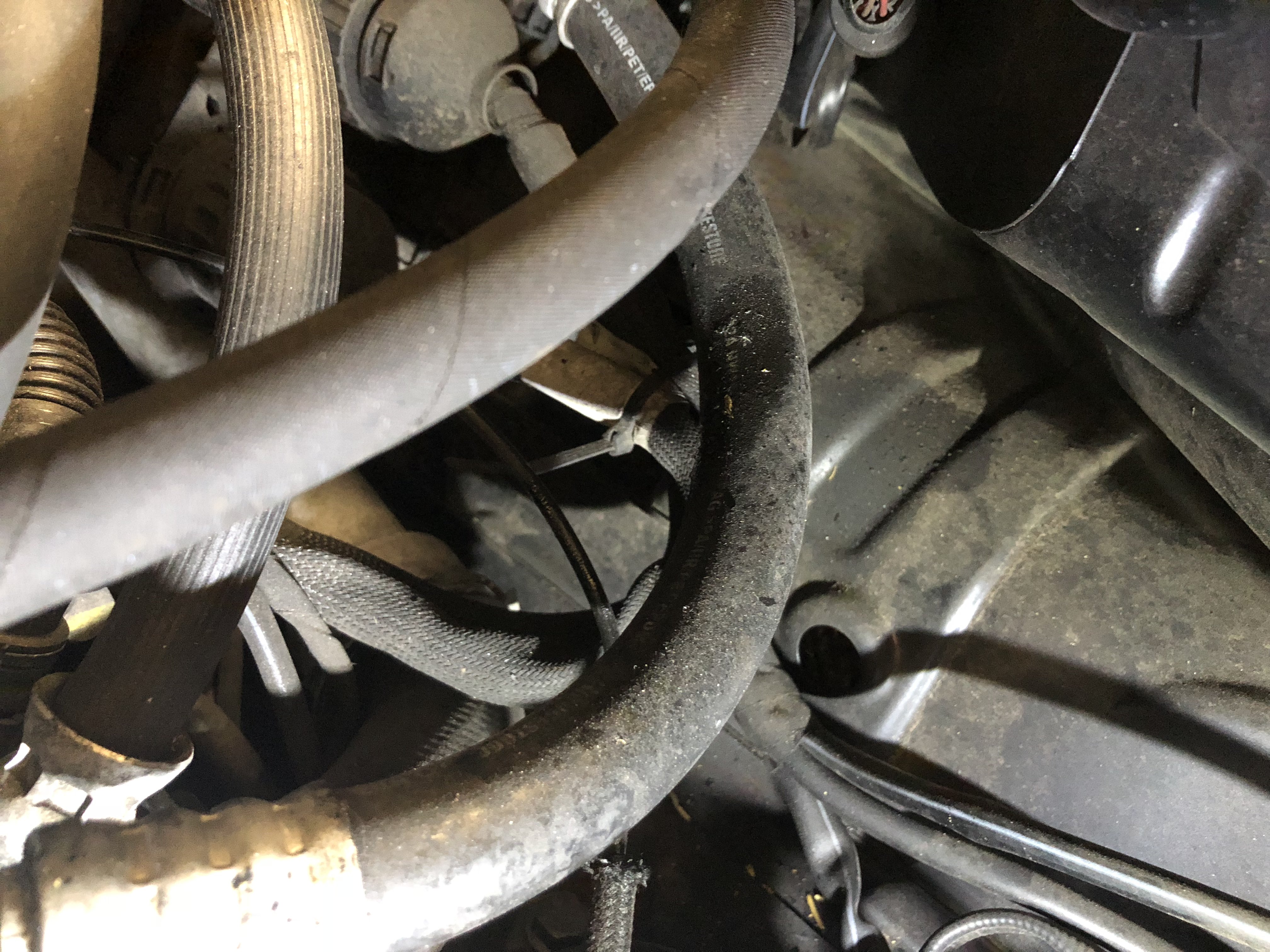

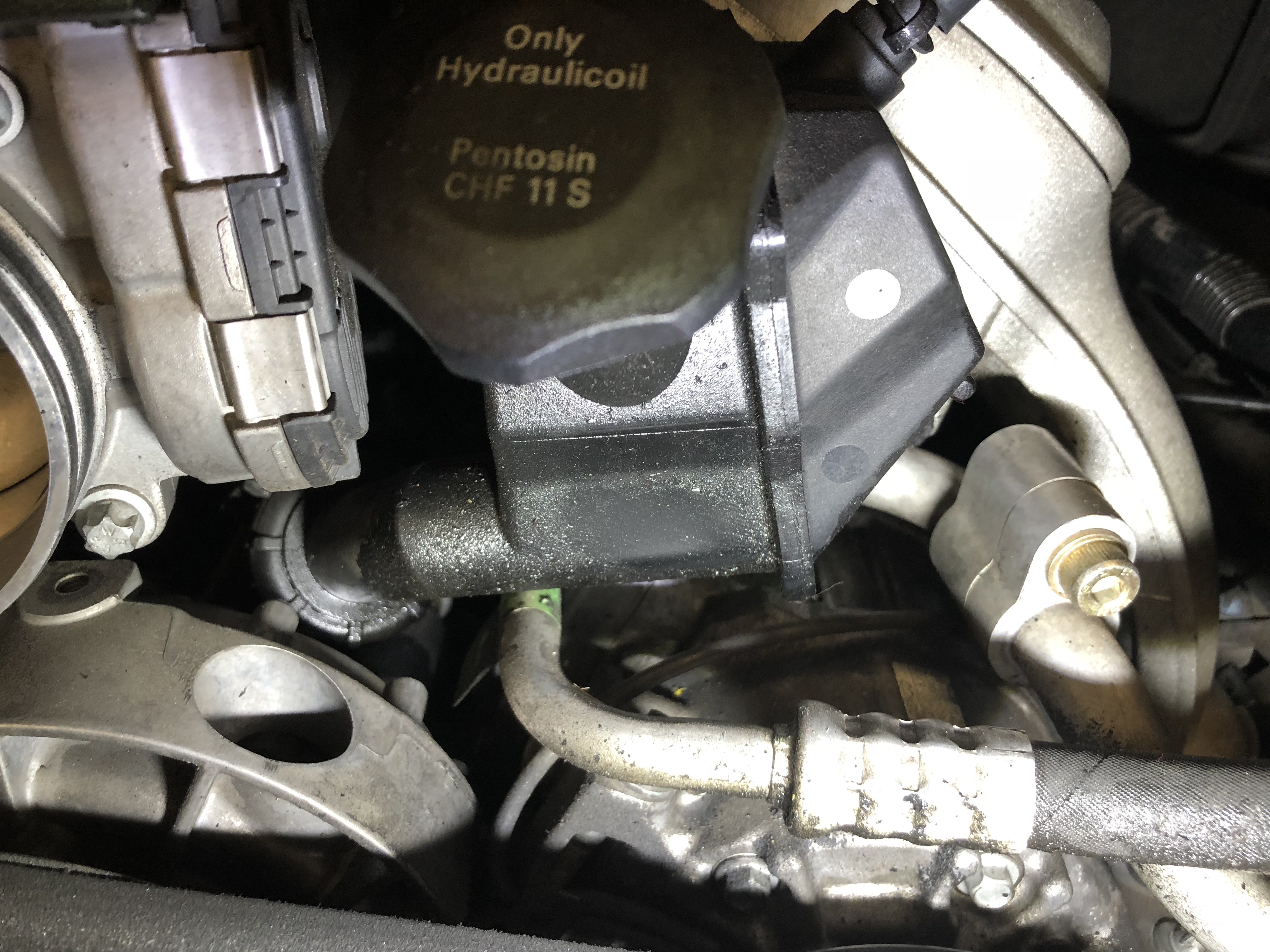

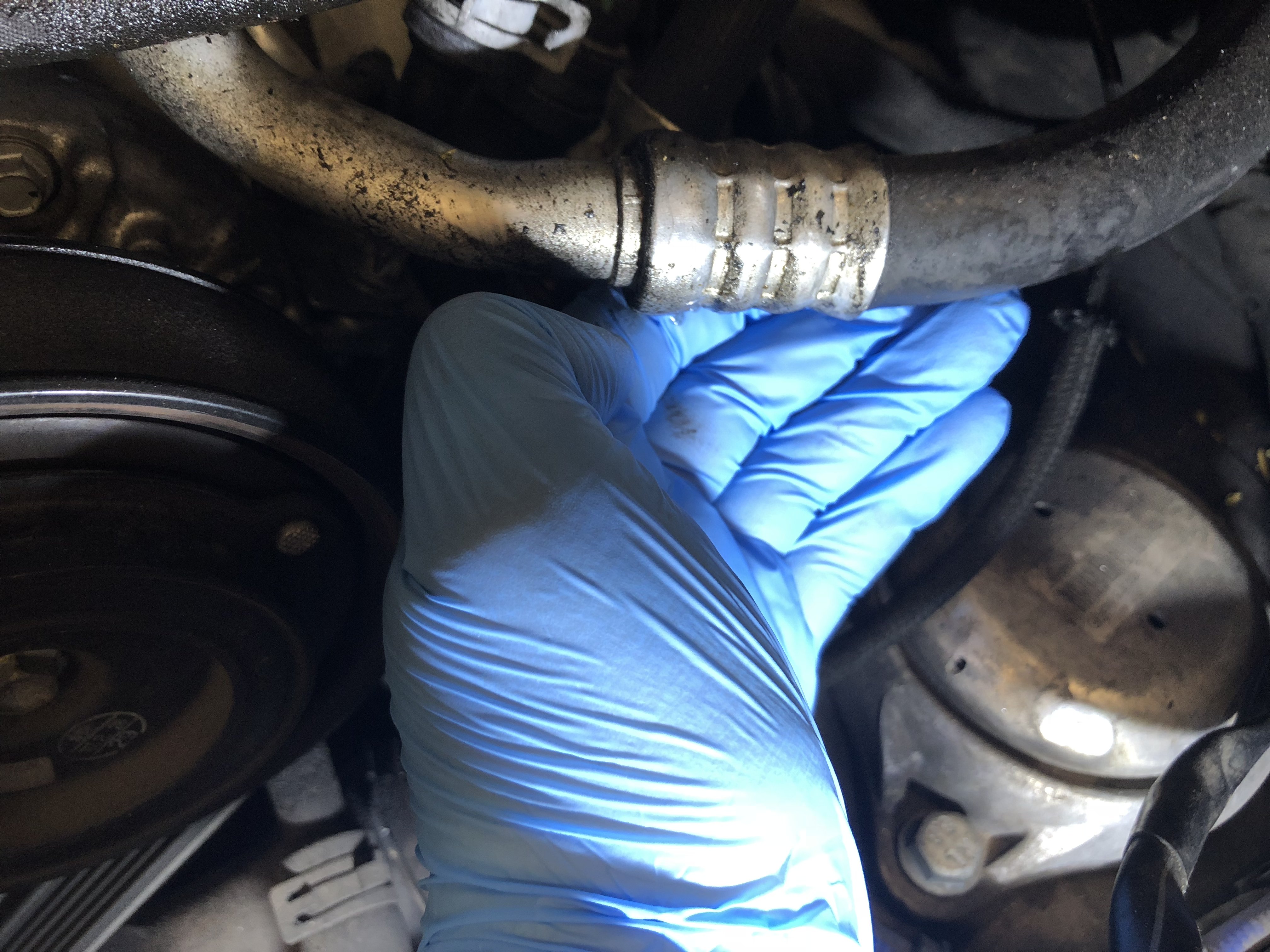

Thanks @wizard. I did find that the engine compartment temp sensor is loose. Can't find where it attaches, so it is possible the grommet or rubber sleeve within which it sits is lost now. Will get one from a dealer. More concerning, as I inspected the engine, I noticed signs of a leak. My AOS was replace a few months ago, and then I don't remember seeing these leaks. The body of the power steering tank is wet and there seems to be some liquid pooling on top of the compressor below it. Further the lines shown in the photos also seem to leak (AC lines??). what do you make of this? Thanks
