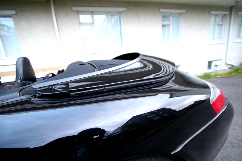

  6. Thank you guys for your answers. The lid doesn´t close completely... ( but it closes when the top is up ) I´ve had a very good look at the rods etc. attached to the lid and everything seems to be ok. So my guess there´s either some fault code preventing this or a sensor. I took it to the dealer this morning and I have to wait for a few weeks :cursing:
  7. Does anyone know if there are any switces I can check? I somehow expect the problem is minor, because I can close the convertible with no problems..
  8. Looks like I didn´t search well enough... :) http://www.renntech.org/forums/index.php?showtopic=6967 probably the cause.. Well that didn´t work.. :( Any ideas, anyone? Throstur

  10. Hi everyone, I tried to open the top and the lid didn´t close completely(see attachment), any ideas? What I´ve tried already is: ..find a similar problem here on the forum :) ..opening and closing the engine compartment, then trying again ..door and switch inside opening/closing the top, same.. ..applying the handbrake, I get the light on the dashboard - switch works Throstur
