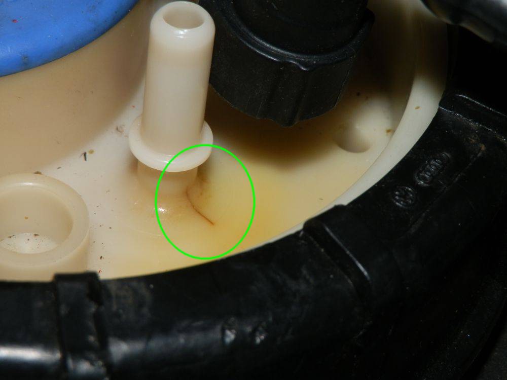

  23. I just changed out my sending unit - took less than an hour. For GromitlnWA, you might thy this first and see if it solves your problem before you shell out $1350 to replace the pressure line.
  24. I'm a big fan of (when appropriate) buying used Porsche parts from reputable Porsche dismantlers. I believe a sending unit is such a case and I'm going to proceed to swap in the replacement. I don't know that any testing of my current setup would prove anything that doing the swap wouldn't, and I'm not too excited about the risk of a fire with live 12 volts and exposed fuel in close proximity. While your C2 tank is going to be somewhat different than my C4 tank, changing that fuel line with the tank in place would be a serious challenge. If I have to resort to that and try to do it without dropping the tank, my thinking after having inspected from the underside would be (after having disconnected at the tank) to first disconnect that line from any connections/brackets working from back to front, starting at the engine. Then with the entire line free of any connection to the chassis, to use a primary person working from underneath and a helper up top trying to gently facilitate getting the connection end of the line past the initial obstacles around the top of the tank. While you could easily just cut the line and pull it out, doing what I'm suggesting ought to confirm (if you're able to get it out) whether you ought to be able to reverse the process installing a replacement line.
  25. Well, I just crawled under mine and it sure looks like trying to change that pressure fuel line with the fuel tank in place is questionable. While my car is a C4 and I believe that those fuel tanks are shaped differently that the C2's, and those two lines are somewhat/slightly flexible, it would be a challenge. But what appears as a sign of good news on mine is that I've spotted what appears for all the world to be a very small crack in the top of the sending unit housing right at the base of the "pipe" which the fuel lone attaches to. For PTEC: Does this look familiar to what you've found of Cayennes?
