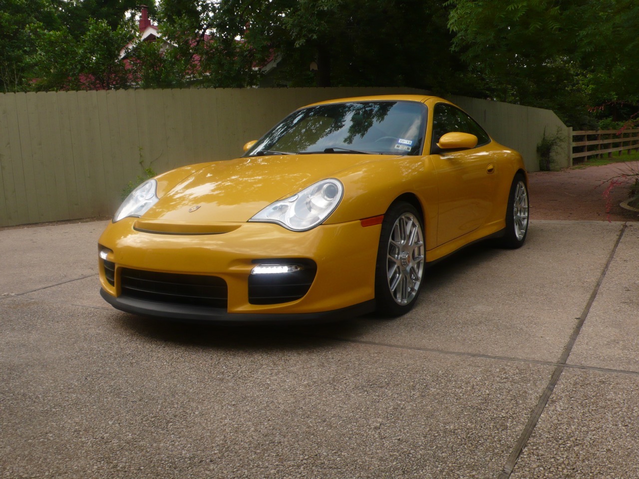

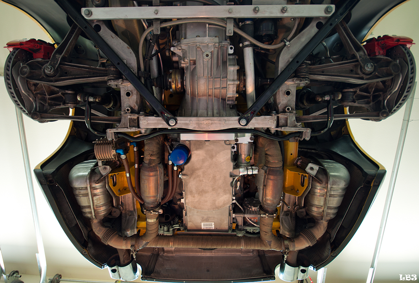

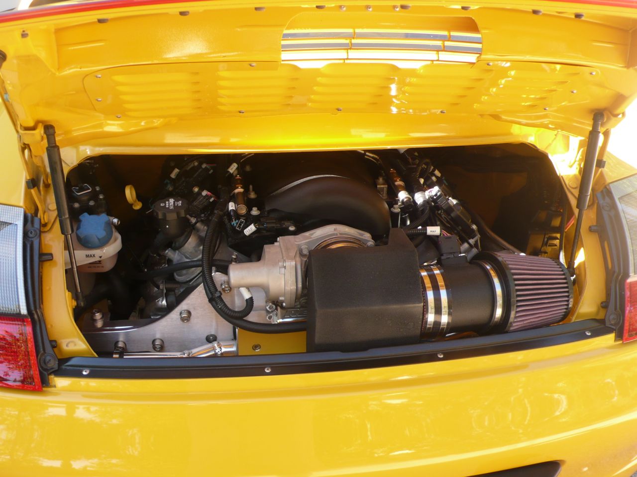

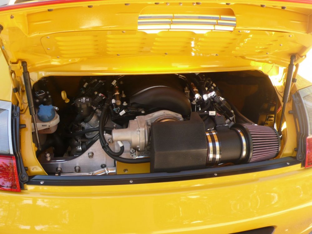

  1. Notice you have a conversion, I have a 2003 LS3 996 C4S with a 495 HP.  I have 20,000 miles on the new engine, I'm doing another car project and have my Porsche for sale.  If you know of any potential buyers please send them my way, and yes...  The A/C works as well as the cruise control.
    There isn't another conversion that is as good as this one, I've invested a 1.5 years in the conversion and 100K, asking $69,750
