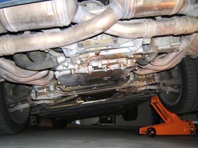

  18. Hey guys, sorry to resurrect an old thread that beat this topic to death, but I wanted to make absolutely sure I've selected the right location on the engine from which to jack up the rear of the car. I've circled what I believe to be the right location in the picture below. Is this it? Thanks!
