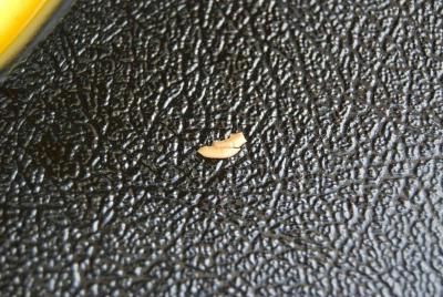

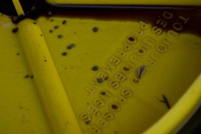

  5. Thanks. Are these analysis expensive (cheaper than an engine replacement I guess!)? I have the oil from this last change and have kept the filter and deposits.
  6. Thank you, No other internal maintenance done since the last water pump replacement. Could it also be the AOS on the way out? It has been 30K since last replacement. Wondering too if I should check the spark plug tubes? thinking of all the places higher up the engine that could have an oil seal that goes bad without showing itself.....

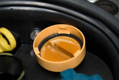

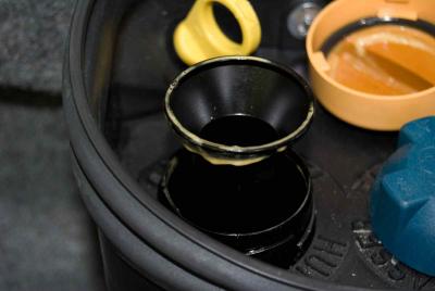

  7. Thank you. Looks like the suggestion is water pump or tank. Was this related to the picture of the gunk in the cap? I changed my water pump about 20K miles ago - failed on the bearings and broke fragments off the fins (black plastic). That was at 43K miles. I'll check it through again. Water level looks normal (I check it every month and it is right between high and low as normal. I was also wondering about the oil/water heat exchanger. Maybe I have two problems? - one causing gunk and the other causing the fragments? thank in advance. Mark.
  8. Boxster / 2000 / 2.7 / Manual / US Changed my oil on the 3000 mile mark this weekend. Everything smooth until I took a look at the drain pan and found some small bits of either rubber or silicone like material. Much more of this in the oil filter. Also some gunk on the oil cap. Pictures attached. Smaller bits appear slightly green. The longer segment shown on the black oil pan is about 1/2 inch and mustard colour (both colours may be affected by oil of course). This longer peice is slightly stretchy but breaks easily. Coolant level is at normal. Regular 8.75 quarts came out of the engine so looks like it is not taking in additional fluid. Anyone seen this kind of thing in the oil before? Pointers to where I should look first? Thanks, Mark.
