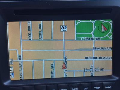

  7. Anybody ever experienced stuck pixels or screen discoloration on a PCM 2.0? We had very cold nights in the last weeks (0 to -20 Fahrenheit) and I noticed a discolored spot appeared on my PCM 2.0 at that time. Doesn't seem to get bigger or smaller overtime. Any clues on a fix beside replacing the screen? Ride is a 2004 CTT. TY
