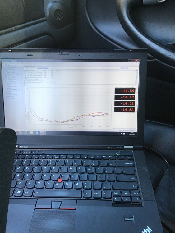

  4. i got some new codes this time p01362 and p01371 how can I Diagnose further with durametic

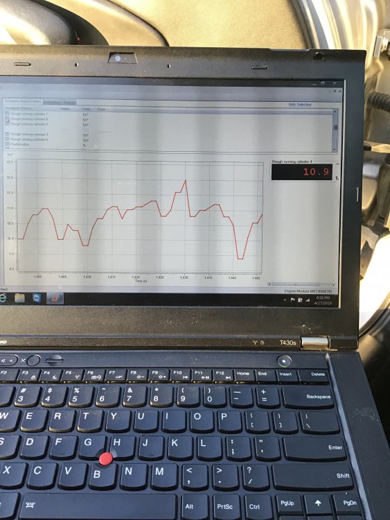

  5. I’ll look at cam deviation in durametric .If I run rpm up it clears up and runs fine . Does not make any noise like lifter or broken spring . Thank you Ahsai for your input

  9. I have a miss fire # 4 in rough running cylinder #4 is higher then the rest but not sure what reading is . All cylinders are about the same low # but #4 is 10 to 13
